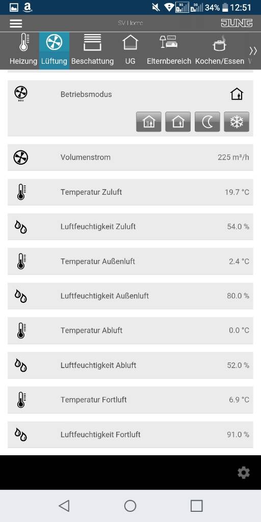

We installed a Zehnder Q350 with an enthalpy exchanger.
I am just starting to familiarize myself with the device; yesterday I installed the KNX module and began configuring it.
Even so, it’s already clear—and what we also feel—that dry air should not be an issue.
Simply very comfortable, I’m glad I insisted on the enthalpy exchanger.
