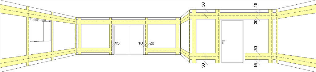

Sebastian79 schrieb:
And nicely slit horizontally This is a 24mm (1 inch) wall, so I’m allowed to cut horizontally or diagonally up to 25mm (1 inch) deep over an unlimited length!
The 11mm (0.4 inch) wall on the left in the picture is uncut.
Sebastian792 Jun 2016 09:56I am not concerned about the structural feasibility, but rather that such a thing could simply be "dangerous" later on.
Sebastian792 Jun 2016 10:00Because horizontal slots are not normally made and no one expects anything there, it is easy to accidentally drill into them.
Because horizontal openings are usually not made That is not correct.
and nobody expects anything there Everyone should assume something here, since this area is designated as an installation zone according to DIN 18015.
so you can quickly drill into it. If a tradesperson drills into it, they are responsible for the damage, because drilling inside installation zones is not done without prior inspection!
And if the homeowner does not know where the pipes or cables are located, they should avoid drilling in the installation zones as well.
