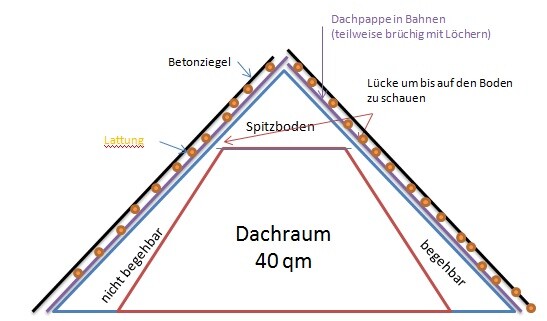

Our house is a classic “coffee grinder” style from 1937 with a hipped roof, meaning it has four almost equal roof surfaces. The roof structure (see sketch) is as follows: roof beams, roofing felt (partially coated with bitumen on the inside), in other areas a foil, battens, and then concrete tiles.
The special feature is that the attic space was practically hung into the roof like a box.
I can access one and a half roof surfaces directly as well as the entire loft; the others can only be insulated from the loft area by stuffing insulation in. The attic was constructed with plasterboard, which was nailed to a stud framework or directly to the roof beams. The floor in the loft partly consists of plasterboard and partly of a wooden paneling (pine) when viewed from above.

1. Can I seal the holes in the roofing felt and install friction-fit insulation? Or can I stuff insulation in from above (here, of course, I don’t know the condition of the roofing felt behind it)?
2. If I only insulate the top floor ceiling, what should I do? Put a foil on and then insulation wool? What about the gaps at the edges that extend downwards? Should I just stuff them so there is no draft? Could condensation form here?

If the roof is covered with roofing felt, you should not install insulation directly against it. Roofing felt is relatively airtight, which most likely will cause mold problems. The best approach is to insulate the ceiling of the upper floor and install a vapor barrier on the heated side. If you want to insulate the attic space, you definitely need to ensure proper ventilation.
