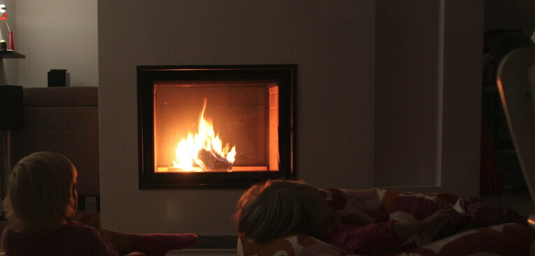

Such a result is not achievable retrospectively, for example:
