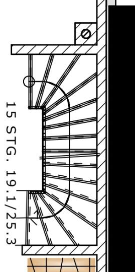

First of all, it’s about the location of the chimney flue. Here is the planning from our architect:

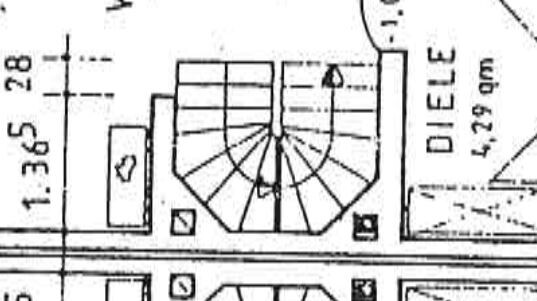

Basically, we don’t have any objections to this. However, from a terraced house that my parents-in-law once lived in, we know this alternative:
Here, the chimney flues are located in the corners of the concrete staircase, so the adjacent rooms are free from “intrusive” boxes, which I find quite elegant.
Now my questions: Does the lower option have any advantages or disadvantages that I should consider? Is it a reasonable solution by today’s standards (the terraced house is approximately 30 years old)?

RotorMotor4 Apr 2019 16:40The lower option is certainly going to be more expensive. How about discussing it with your architect?
If you definitely want to have a piece of the 1980s in your house, you can probably find a Kim Wilde poster somewhere :-)
The desired fireplace system would be labor-intensive to build – constructed with cut small-format bricks; it’s not something that can be made as a prefabricated unit.
