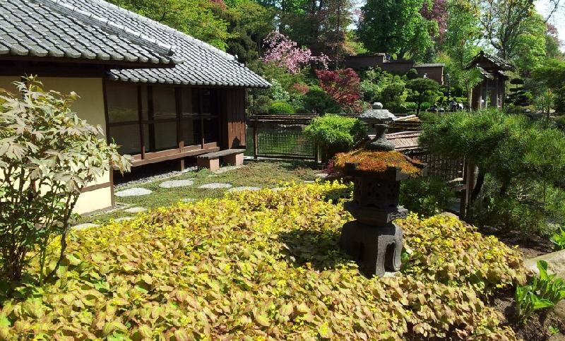

I would like to build a somewhat extravagant house in a Japanese style, with a Japanese garden around it, maybe even a pond. The house should be built according to the latest energy standards but only look different from the outside in terms of design. How and if all this is technically feasible remains to be seen, of course, but is there even building land where you are allowed to build “freely”?

To give an idea of the style I am aiming for, I have attached a photo.

I see a bungalow roof... in a garden...

I attached a photo.
