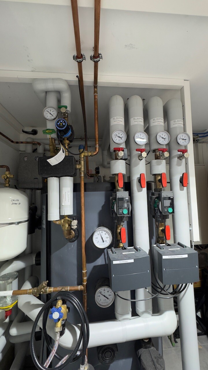

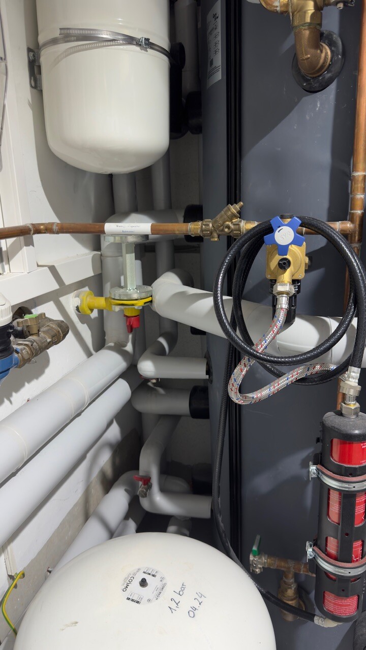

The connections are as shown in the picture, and this has already been checked several times.
I suspect that the lower buffer zone is simply drawing energy from the upper one.
I cannot think of any other explanation, because otherwise, as you said, it would be unreasonably warm in the rooms with the buffer.
The house is very well insulated, and the heating works well as it is.

So, I’ll try one last time. Please take photos of the situation, especially of the connection area of the two heating circuits. Because if everything is as shown in the diagram and the partition plate is also present, then it can only be considered a supernatural phenomenon. In that case, this forum probably won’t be able to help you further.
