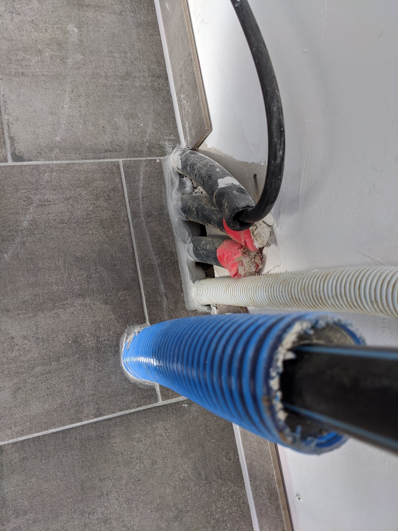

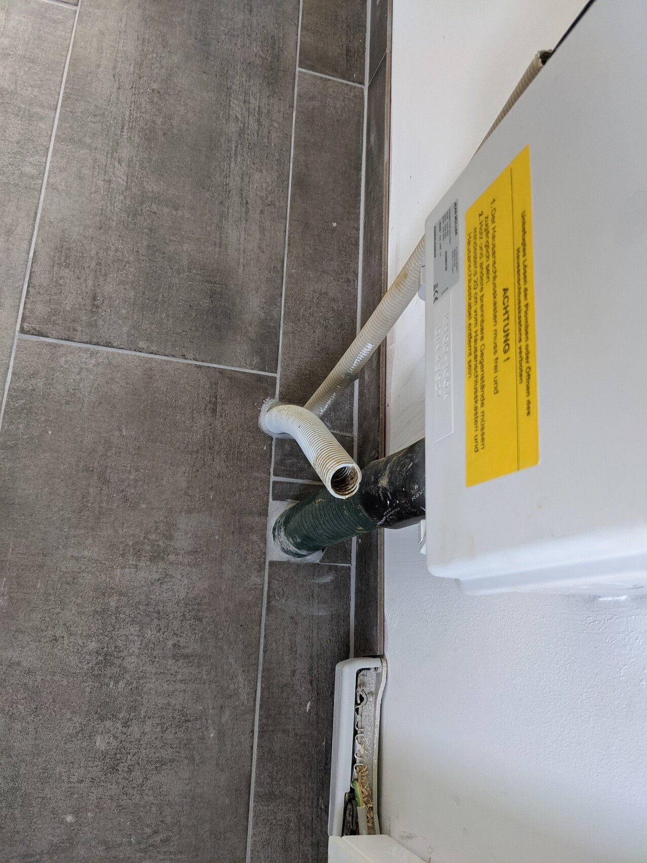

Adunoh198319 Dec 2019 18:32N
nightdancer19 Dec 2019 19:50Adunoh1983 schrieb:
Today I noticed that two empty conduits leading outside and one going to the attic are not sealed at the openings... Could this be the cause of the poor result?That alone is unlikely to be the cause. I attended the blower door test and we checked all the usual weak points.
