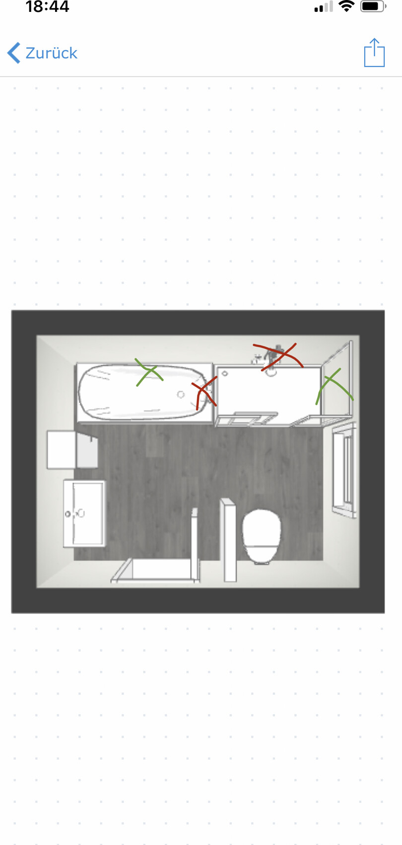

I bought a house and am renovating the bathroom.
The water pipes can be routed freely. The door still needs to be installed, so it can open either to the left or the right.
Attached you will find my initial layout. I think it is already quite optimal. If you have better ideas, I would be happy to hear them.
I have a question about the shower. It is planned to be 1.40 m (4 ft 7 in) wide and 80 cm (31 in) deep. As you can see in the attachment, the shower borders the bathtub in my plan. The opening to the bathtub can remain open. But how do I install a 1.40 m (4 ft 7 in) glass panel with a door? Are there options for that?
I look forward to your answers.

After much consideration, we are sticking with our original idea as shown in the attachment.
