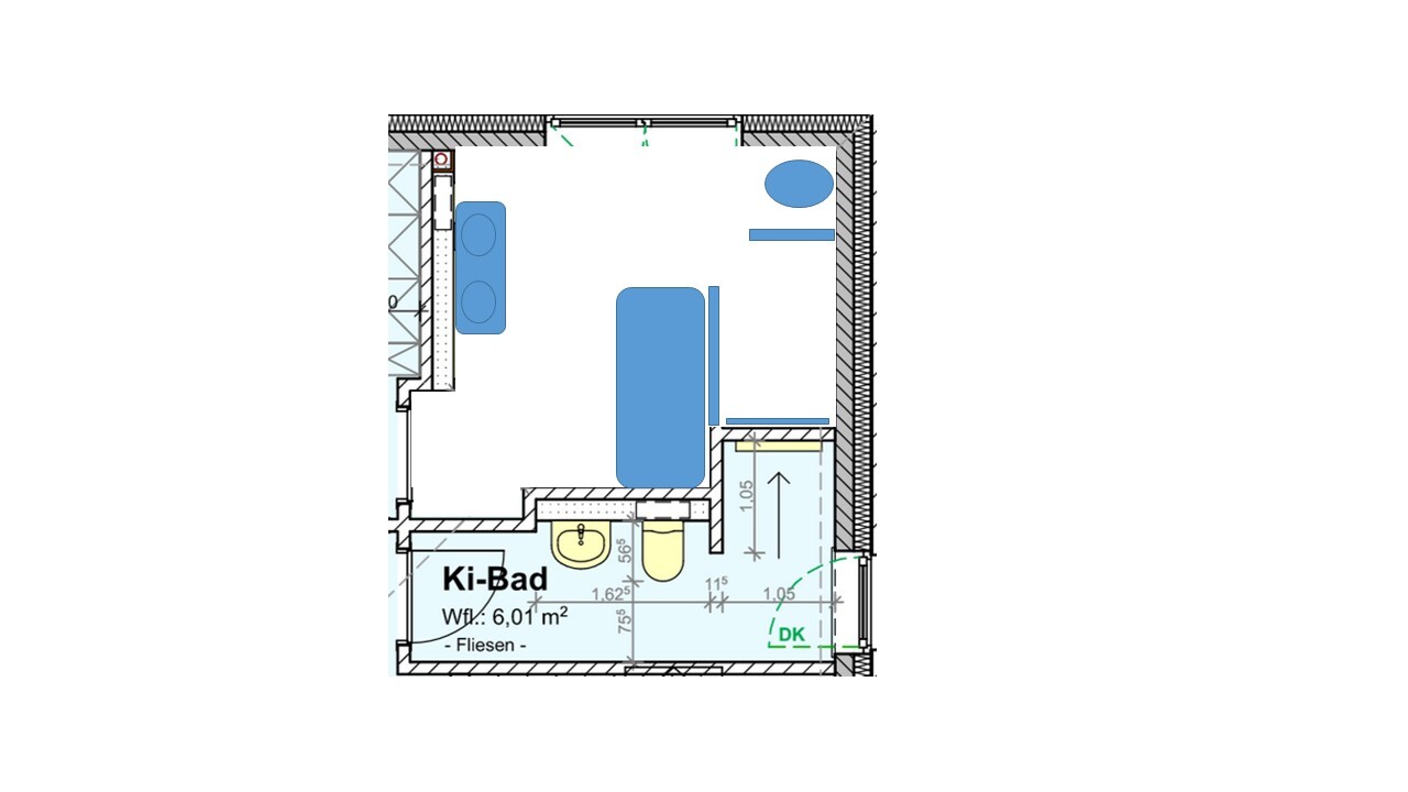

Alessandro17 Aug 2020 14:39Hamburger2020 schrieb:
I made a very amateur attempt to move the bathtub and toilet:
In my opinion, there is no way around shortening the shower wall in the master bathroom slightly (already done), because otherwise it becomes very tight to access the shower. To compensate, I reduced the shower length in the kids’ bathroom by 11cm (4.3 inches) and added 11cm (4.3 inches) extra width in both the master and kids’ bathrooms. However, space could still be tight in the kids’ bathroom, and it remains cramped at the washbasin :/ I wouldn’t like that, as everything feels very squeezed and visually reduces the room size.

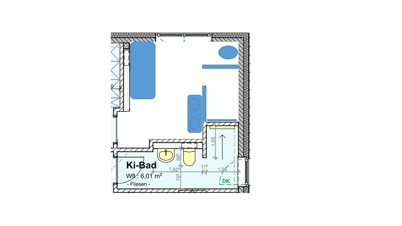

Alessandro17 Aug 2020 14:52A

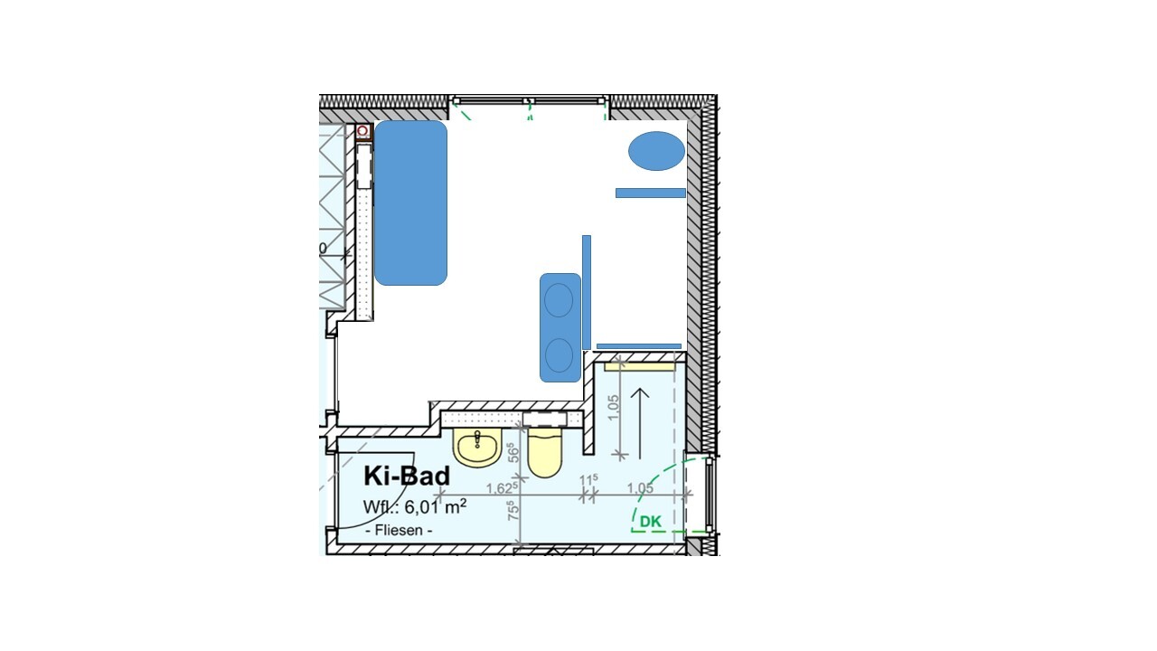

Alessandro17 Aug 2020 14:59A
Alessandro17 Aug 2020 15:05A
Alessandro17 Aug 2020 15:22The laundry chute can be installed at the top left next to the washbasin. I believe it was mentioned there in the original thread, if I remember correctly.
Unfortunately, I don’t see any other option if the toilet is not supposed to be directly next to the bathtub or washbasin.
