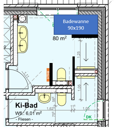

For some reason, our previous post was deleted.
So, I am trying again. If there is anything inappropriate about the question, please let me know briefly so I can adjust it accordingly.
We are currently in the detailed planning phase while waiting for the building permit / planning permission.
Our requirements/wishes for the bathrooms are as follows:
Master bathroom
Double sink (or a single sink with two faucets) with vanity cabinet
Walk-in shower with floor-level entry (at least 90x120cm (35x47 inches), preferably 90x150cm (35x59 inches))
Bathtub 90x190cm (35x75 inches)
Toilet with privacy screen
Heated towel rail
Children’s bathroom
Walk-in shower with floor-level entry (90x90cm (35x35 inches))
Toilet (with privacy screen if it fits)
Sink with vanity cabinet, ideally 90cm (35 inches) wide to allow two children to get ready comfortably at the same time
Heated towel rail if there is space
In general, the children’s bathroom can be simpler than the master bathroom. The kids already have a large part of the upper floor area, so a nice bathroom should be our luxury.
Currently, we find the bathrooms on the upper floor a bit suboptimal (see attached), but we have not yet come up with a better solution. The children’s bathroom basically fits well in our opinion, but since both rooms are next to each other, changing one might require adjusting the other.
What we particularly feel is missing is a privacy screen for the toilet in the master bathroom. At the moment, it looks like there is no room for this. Also, the space between the sink and the bathtub seems a bit narrow to me (currently, only a 45cm (18 inches) deep sink is drawn, and we have chosen a 90cm (35 inches) wide bathtub (190cm (75 inches) length, but this shouldn’t be an issue here)), so it doesn’t seem easy to comfortably pass by each other (with a 45cm (18 inches) deep sink and an 80cm (31 inches) wide bathtub, there is 114cm (45 inches) of space).
Are we overthinking this, or do you think it already works?
We would appreciate your feedback and tips!
Thank you very much

Hamburger202017 Aug 2020 15:33Yes, the laundry chute would also fit to the left of the window. However, I am concerned that it will be quite tight near the shower, regardless of the glass door.
But thanks for the tips, the more ideas the better.
Alessandro17 Aug 2020 15:36A
Alessandro17 Aug 2020 15:37Hamburger2020 schrieb:
Yes, a laundry chute would also fit to the left of the window. However, I’m afraid it might make the space around the shower quite tight, regardless of the glass door.
But thanks for the tips, the more ideas the better A 60cm (24 inch) opening is more than sufficient for the shower.

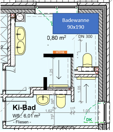

Hamburger202017 Aug 2020 15:50A
Alessandro17 Aug 2020 16:03This makes it very difficult to get into the bathtub, and the HTHK is also located in a very inconvenient spot.
Hamburger202017 Aug 2020 16:59Alessandro schrieb:
that makes it really difficult to get into the bathtub, and the heated towel rail is also positioned in a very impractical spot. That wouldn’t be decisive for me. We currently have a heated towel rail right next to the shower, but we only use it to warm the room, not the towels.
Still, I think I prefer your last version better.

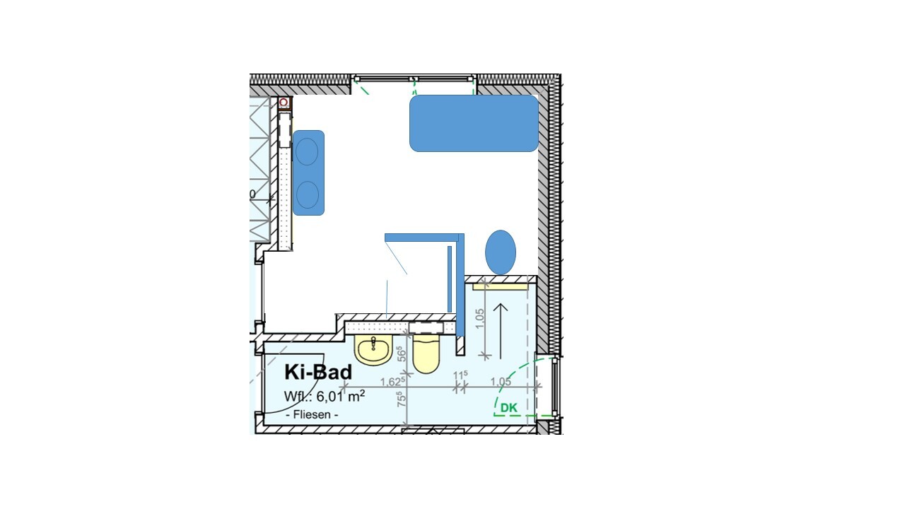

I tried to draw it to scale:
You could also reduce the shower to 90cm (35 inches) internal width and still make it a bit longer than the current 125cm (49 inches) internal length.
