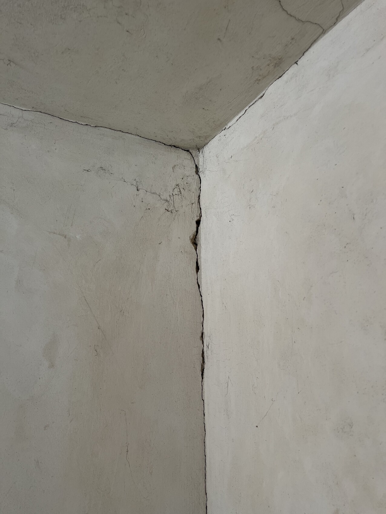

  • Serious settlement cracks throughout the upper floor on exterior and interior walls and ceilings, in some places more than 0.5cm (0.2 inches) wide (photos attached)

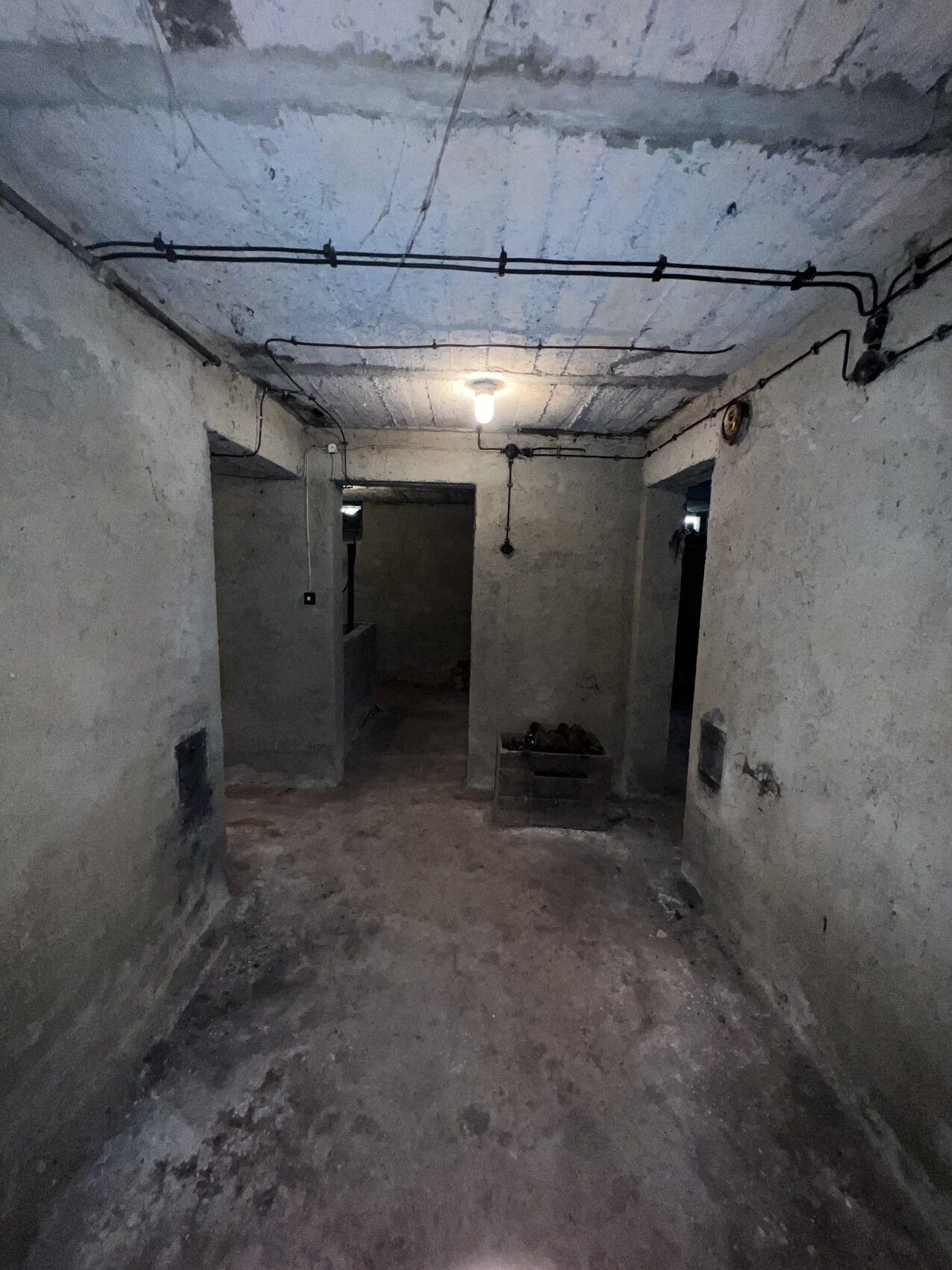

  • Cellar is damp, with no insulation or waterproofing
  • Uneven clay floor throughout the cellar level
  • Ceiling height in the cellar approximately 2.20m (7.2 feet)

Photos of the largest settlement cracks:
Interior with wall and ceiling cracks, visible construction defects
Corner of two plastered walls with vertical crack at the edge, ceiling visible.
Large wall crack in an interior room; diagonal crack running from ceiling to corner.
Photos of the cellar:
Concrete cellar room with damp, dark floor, light bulb on the ceiling, and small window.
Dark cellar room with central wooden post, hanging light bulb, damp floor and walls.
Dark cellar room with pipes, narrow hallway, metal door, damp floor and a light fixture.
Dark concrete cellar with ceiling pipes, visible light bulb and a box on the floor.
As a layperson, I suspect that the cellar is not suitable as a base for a new building. If the experts have a different opinion, how could the cellar be safely filled in? Or would it be better to remove it entirely given the background?

Filling cracks does not eliminate their underlying cause.

Overall, I will limit myself to a brief summary here, as I do not want to examine the property in detail. I dare to say that the basement does not suggest any preservation value, and a more detailed investigation is not worthwhile. Therefore, I advocate for a complete demolition, meaning the clearing of the site from the building in its entirety.
