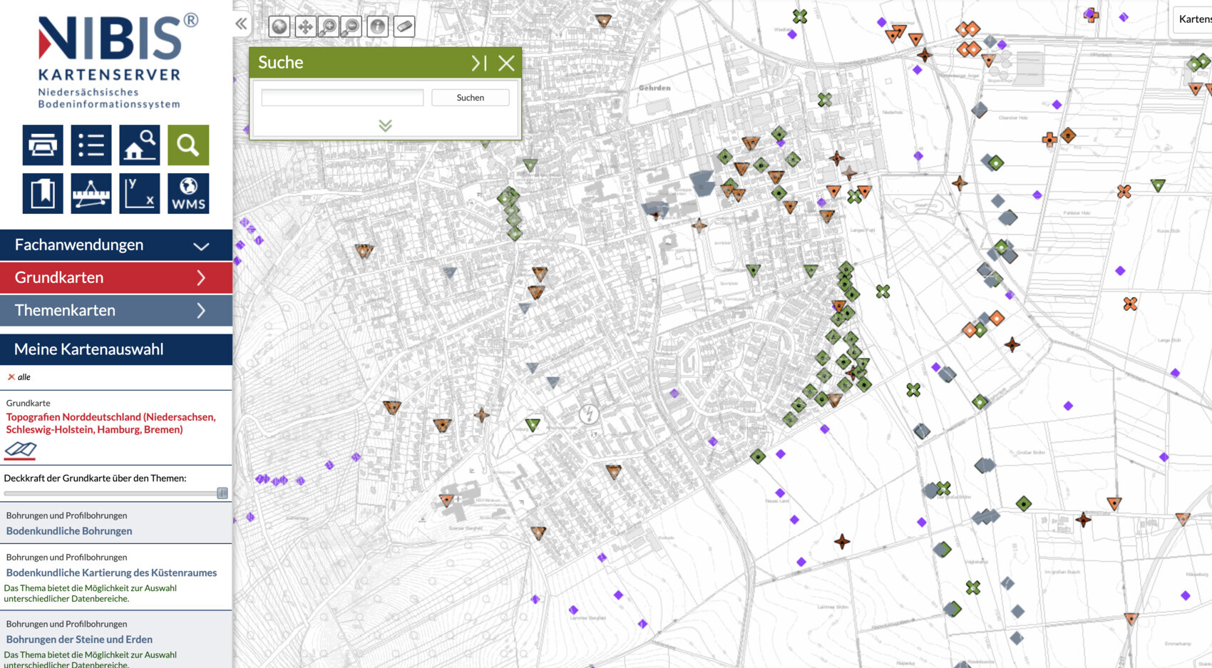

There is a "drilling point register" for Lower Saxony. This includes, among other things, drillings for heat pumps (which I have just verified). In some cases, the drill casings are also included.
No idea which federal state you are looking at.
NIBIS Kartenserver: Stadtkarte mit farbigen Markern und linkem Menü.
