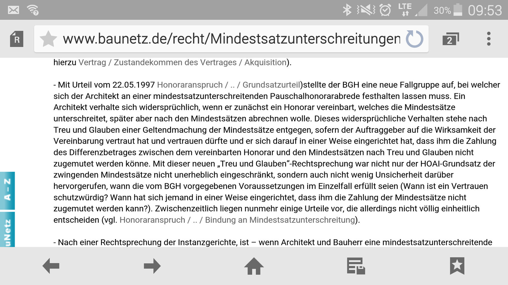

The worst case is that the minimum rate is applied and you have to pay. Whether you forego the 20% discount now or maybe later — better perhaps later — but I would put that money aside. Well, whether I succeed will probably be decided by a judge in the end. I won’t look for solid evidence now; however, a quick Google search brought up the following.
In particular, I have never heard of a case where a claim was successfully enforced through a court ruling.
It’s almost impossible to prove that a client “walked straight into a trap.”
