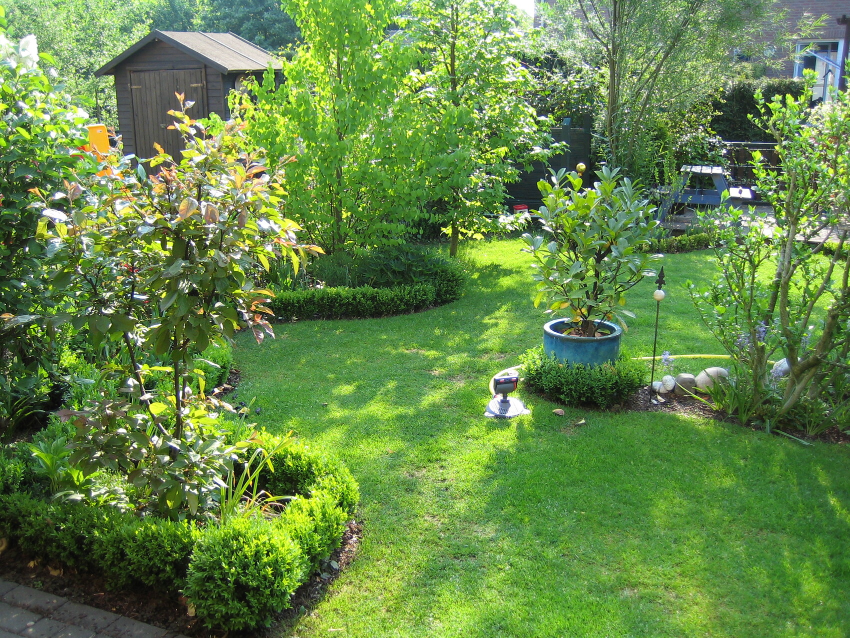

Make a small flower bed around it—optionally with a 20cm (8 inch) boxwood hedge. That way, the pipe is nicely integrated.
We had an inspection shaft for an infiltration system in the middle of our terraced house garden and initially not much budget for a structural solution. The shaft is located under the flowerpot (center-right in the picture), and the flower bed was shaped accordingly. This "temporary solution" lasted until the house was sold. It looked quite nice, didn’t it?
