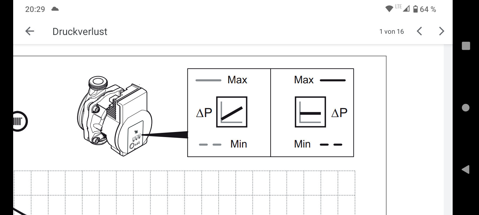

Based on the cold outside temperatures, I’ve been running the system since last night with a 0.10 heating curve (can’t go any lower) and a flow temperature of 25°C (77°F). The only interruption was for domestic hot water preparation. Currently, the indoor temperatures are around 20°C (68°F) to 21°C (70°F). I have now adjusted the heating circuits again and hope the bathroom will get warmer.
Additionally, I’m hoping that when I take a closer look at the heating circuit pump tomorrow, it is set to variable flow rate rather than constant flow rate. If I can switch it, I expect to get more flow in the heating circuits.
