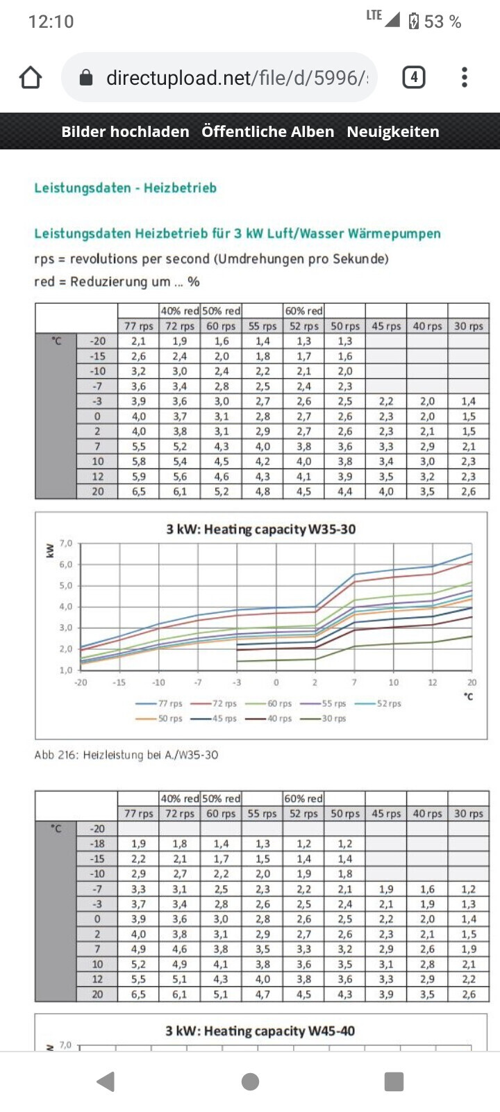

My system
Vaillant Arotherm-Split 3.5 kW heating capacity
House heating load at -12°C (10°F) approximately 2.5–2.8 kW
At the moment, I have limited the capacity using the boosting mode. However, it still can only go up to 60%, so the system is still delivering too much power.
ERR valves are disconnected, and the bypass valve is either closed or set to the maximum opening pressure required for the bypass to activate.
Since the heating load at the current temperatures is likely hardly more than 1–1.5 kW.
My system
