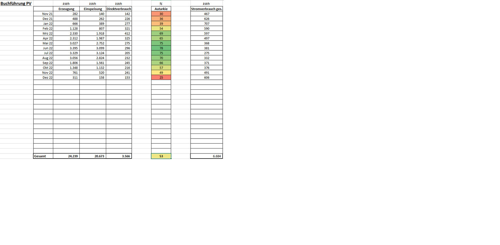

KingJulien31 Dec 2022 21:51
PV accounting table with generation, feed-in, direct consumption, and self-sufficiency
Here’s my input in Excel for when words are not enough.
23 kWp – December ’22 had almost 2 weeks of snow on the roof – no BEV yet.
Heat pump consumption: 1960 kWh, including hot water.
So, I hope statements like “December + January yield = nothing” and “more than 5% self-sufficiency isn’t possible” can be put aside as just casual talk, at least when the roof has been used sensibly.
Oh, and Happy New Year! 🙂
Pitiglianio
31 Dec 2022 22:13
KingJulien schrieb:
So, here’s my input in Excel
Thanks to everyone for the numbers and facts.
I used your figures. According to your data, calculated over 12 months, with estimated electricity costs of 40¢/kWh, you save 1266 euros annually. In addition, with a feed-in tariff of 7.5¢, you have an income of 1500 euros per year. That adds up to 2766 euros annually. Or am I missing something? Have a great start to the new year.
KingJulien31 Dec 2022 22:40
I’m not going to double-check the calculations now, but it’s probably correct 😉
