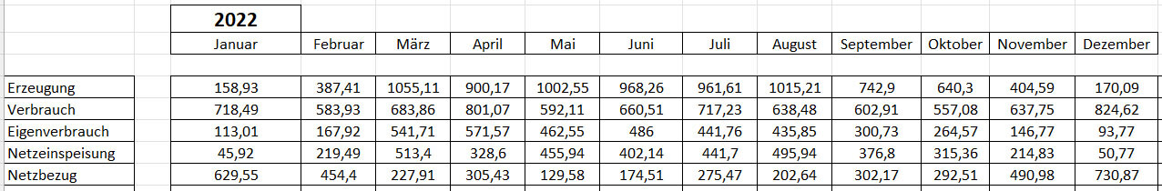

My system is, of course, not representative. Additionally, I use it to charge my fully electric vehicle, which averages about 1200 km (750 miles) per month (December was slightly higher), which naturally improves the self-consumption rate significantly. I have not yet included the electricity consumption for the separate heat pump in the table... My system has only 6.5 kWp, but it is optimally tilted at 45° exactly south-facing, which is advantageous for winter. The system planned by the original poster will achieve different (worse) winter values. However, the 1290 kWh per installed kWp is more than both I and the solar installer had expected ;-)
