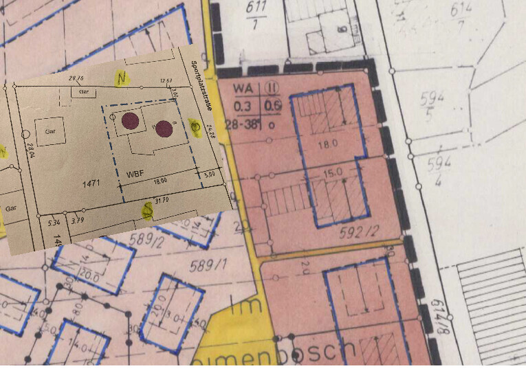

Daniel55Hello everyone,
My sister and I share a plot of land (approximately 11 ares), which we want to divide equally.
My wish is to build a narrow detached single-family house on my half, while my sister prefers to build a semi-detached house. For me, greater privacy is the most important factor, whereas my sister does not want to give up on the “width.”
Do you have any ideas on how we can both achieve our goals? We have already considered various options, from staggered semi-detached houses to two detached houses—but neither party has ever been really satisfied. I would appreciate any suggestions. Perhaps someone here has faced a similar decision? Can you imagine a terraced house?
Regarding the floor plan, I have not thought much about it yet. It is important that the living/dining area faces west at the rear and has a full glass facade.
Plot size: total 1,069 m2 (approximately 11,500 ft2)
Slope: no
Site coverage ratio: 0.6
Floor area ratio: ? – unfortunately, I cannot find this anywhere
Building window, building line, and boundary: see graphic
Edge development
Number of floors: 2
Roof type: gable roof (according to the development plan) – ridge direction north to south
Architectural style
Orientation
Maximum height/limits
Other requirements
Basement, number of floors
Number of occupants, age: male 34, female 29, possibly 2 children in the future
Room requirements on ground floor and upper floor: ground floor for living, upper floor for bedrooms + office
Office: family use or home office? Home office
Overnight guests per year: -
Open or closed layout: open
Conservative or modern construction: conservative
Open kitchen, kitchen island: open kitchen to dining area, kitchen island if possible
Number of dining seats: 6
Fireplace: yes
Music/stereo wall: TV only
Balcony, roof terrace: none
Garage, carport: both possible
Utility garden, greenhouse: no utility garden, only lawn (possibly swimming pond)
Additional wishes/special features/daily routine, also reasons why certain things should or should not be included
We also asked the building authority whether we could build outside the permitted building window, but this was immediately rejected.
Thank you very much for your replies.
Daniel

The development plan is called "Am Rothweg," the first result on Google. Plot no. 1471, I have attached an image with a larger radius.For now, without any ideas, I have attempted a synopsis of the images:https://www.instagram.com/11antgmxde/
1461 is a street (Sattlerweg) with a cul-de-sac. If detached houses are absolutely necessary, I would suggest checking with the city whether access via this street is possible. House number 12 also has access to its garage through the dead-end street "Töpferweg." The plots could then be divided into a west and an east parcel. The building boundaries would remain, but given the development at houses number 10 and 20, there might be a chance for an exception here as well, which should also be clarified with the city. Google Earth also suggests that further densification in this area was permitted for newer houses.
Personally, I think a staggered semi-detached house would look better. This would leave a nice, long garden facing west-southwest, without neighbors looking directly into the windows.
@RomeoZwo
Thank you for your reply. We had already asked the city in advance whether your suggestion would be possible — but they rejected it immediately.
From what I understand from their responses, a duplex does seem to be the only reasonable solution....
Merry Christmas!
Merry Christmas!
A glimmer of hope might be that the plot is located at the edge of a zoning boundary. It could be worthwhile to study the planning objectives of the neighboring zones: being at the edge or corner of another zone, I see better chances to apply for a variance towards the standards of that area.
