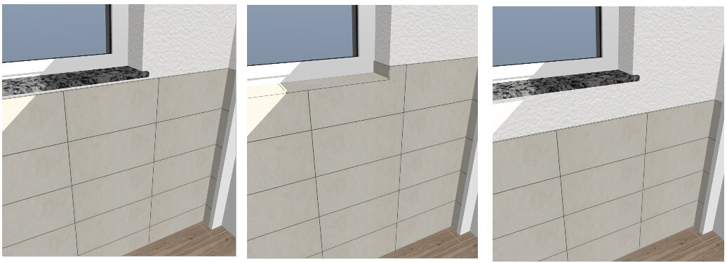

bauenmk202012 Dec 2021 17:57
I can recommend Cadvilla. I traced the floor plans from the offers as well as the property layout. Over time (almost three years now), I have continued to use the drawings. I also marked every power outlet and created 2D derivations.
My requirement was:
The software should not only provide a rough overview but also allow the creation of detailed drawings later on, as well as the ability to create or use custom 3D objects.
I have invested several hundred hours into it. Currently, I am planning the outdoor area. The options are both a blessing and a curse. It is easy to get lost in details when you want to plan access paths, curbs, front gardens, drainage, etc. with centimeter precision.
Here is an example of how the program helped me and allowed me to explain certain "issues" to my wife. In this case, it was about the tile height in the guest bathroom and whether to tile the windowsill or not.
PS: In the end, except for the top of the windowsill, everything was tiled.
Three-part interior shot: beige tiled wall, dark granite windowsill, window at top left
