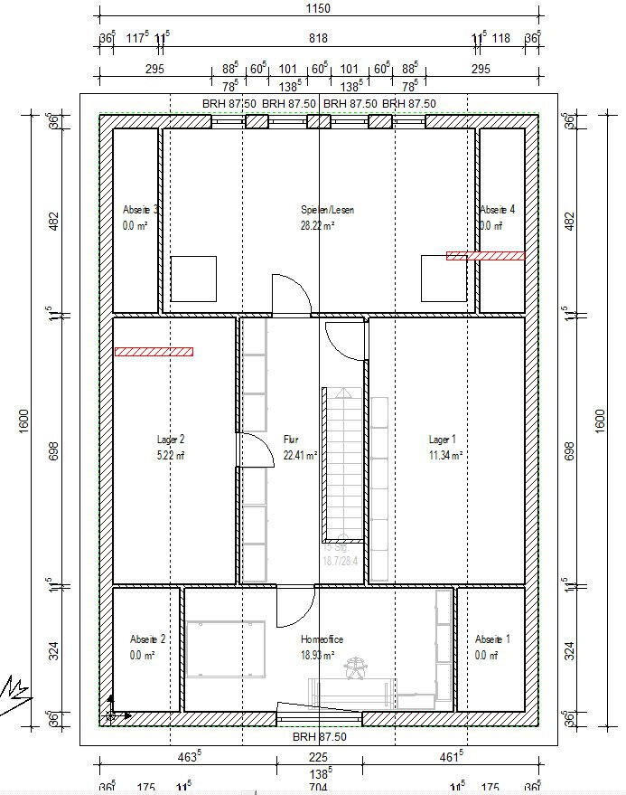

We are currently discussing the floor plan by Chrisi1906, who also wants to build a bungalow with a roof.
One of my designs resulted in this roof:
It has a 28° angle, 0 cm (0 inches) knee wall, but is 1150 cm (380 inches) wide.
Your plan is 1050 cm (329 inches) wide, but you need to choose at least a 30° angle. You should sketch this out to see the resulting spaces. They will probably be similar to those in the roof shown above.
