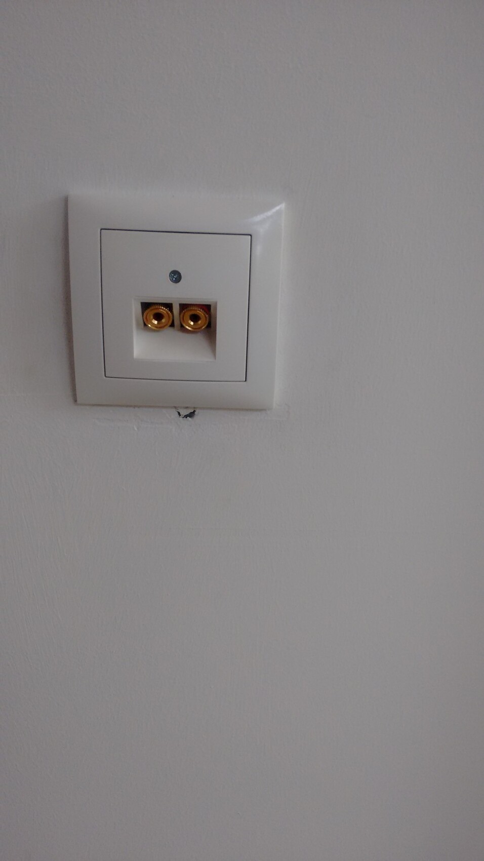

G-Star198818 Sep 2017 12:37Oh no, sorry, it has nothing to do with electrical cables, etc. It is only about speaker cables.
I installed a 50x110cm (20x43 inches) conduit originally designed for ventilation in the wall to accommodate the TV cables.
For the speaker outlets, I used DIGITUS DN-93831-1 Keystone front plates along with DELOCK Keystone banana plug terminals 86303. In our case, we paired these with the Berker UAE cover 14098989. Unfortunately, the terminals are a bit "thick" and rest on the cover. I improvised by pushing them further back into the box; normally, they would protrude more.
I found this solution more visually appealing because you can see the outlet from the side behind the box. I think banana plugs make it look a bit nicer in this regard.
Right behind the stereo system, I ended up using the Gira 4-gang 569403 together with the mounting frame 264803. It obviously doesn’t perfectly match the Berker system, but I think it works well enough. There aren’t as many outlets there anyway.
