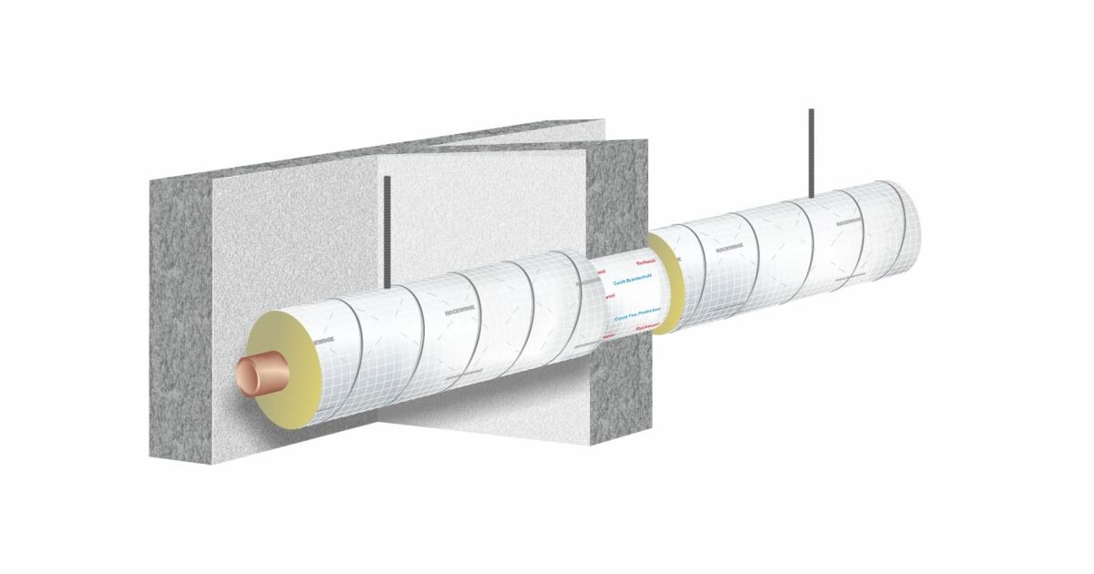

As part of preparing for an air conditioning system, we routed six refrigerant lines and corresponding cables through a wall opening to the balcony. Insulation material will be applied around it from the outside.
Next week, plastering is scheduled, and I now want to fill this hole.
What would you recommend using for this? Foam, mortar, or something else specifically designed for this purpose?

Deliverer14 Feb 2018 10:58Before using the expanding foam canister, perform a finger test:
Anything that can be crushed between two fingers will also be crushed by the expanding foam.
