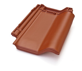

1. ABC roof tile modena11

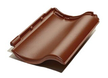

2. ABC roof tile tg 10
The building material supplier said that Modena 11 is better because it has an extra lateral groove, which prevents wind-driven snow and heavy rain from getting underneath the tile.
What is your opinion on this?
I would choose a color to match the brickwork, but should it be high gloss, matte, or something in between? I feel high gloss might be better as moss or similar growths might form less quickly(?), but high gloss on a large roof area (bungalow)! What do you think?

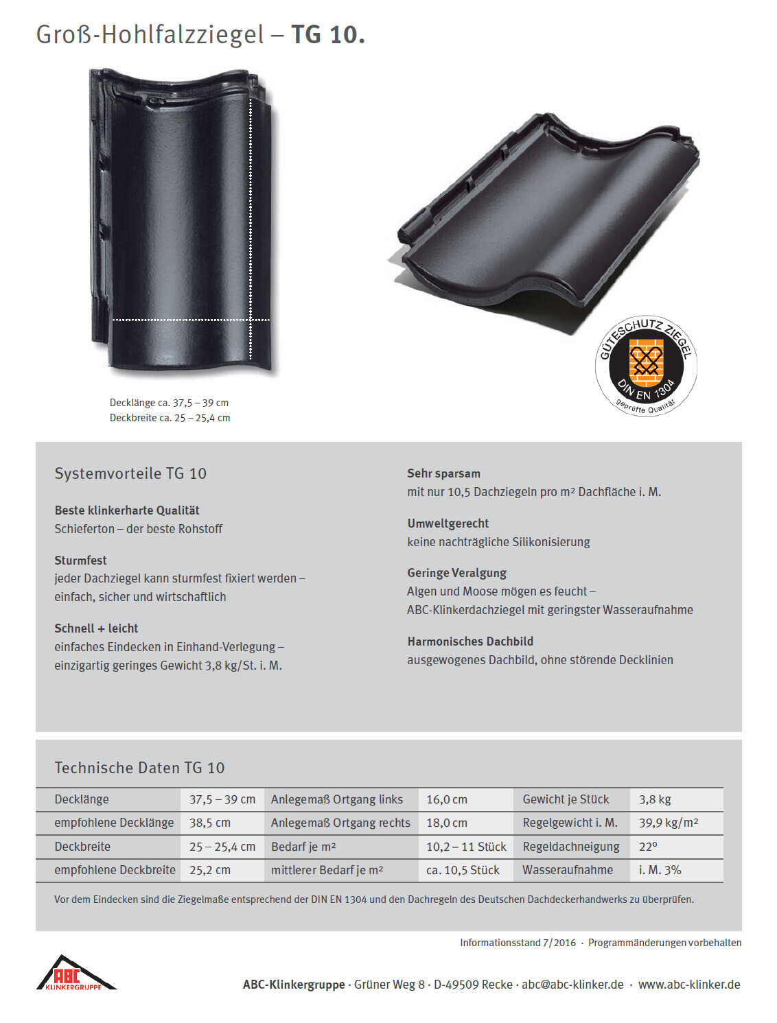

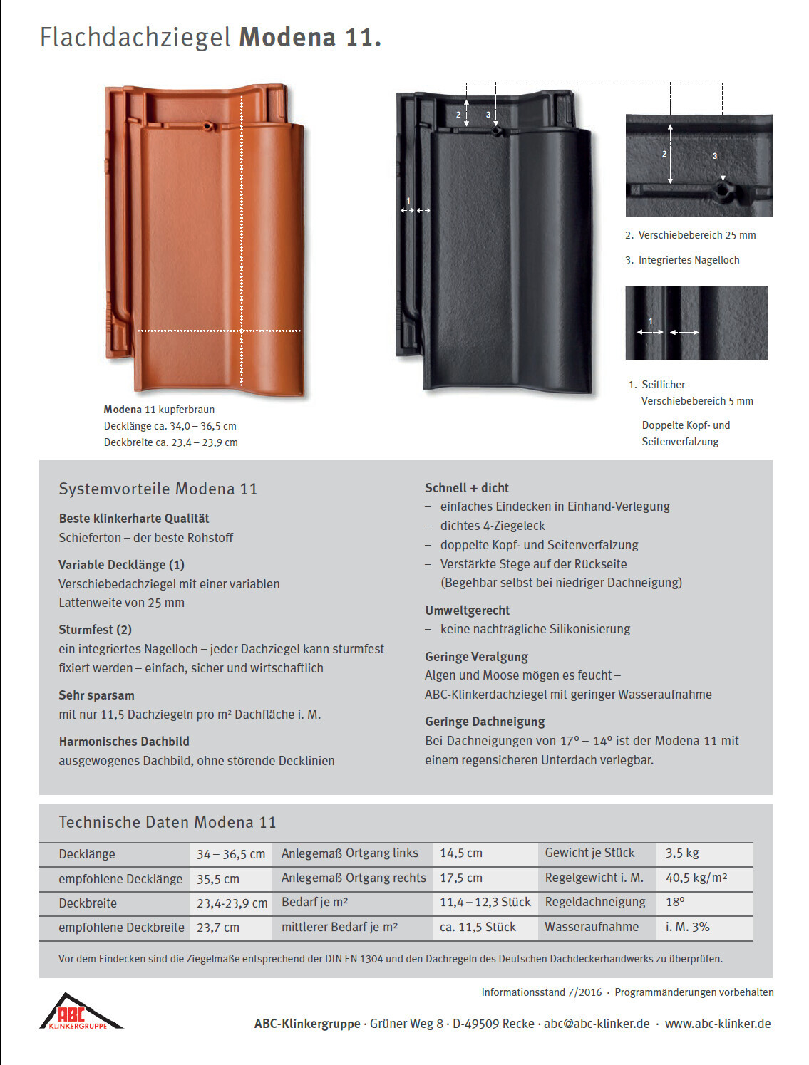

But regarding functionality, I have no idea. I don’t want to ask the site manager either, as they will probably just praise whichever is easier to install. Here are the data sheets:
