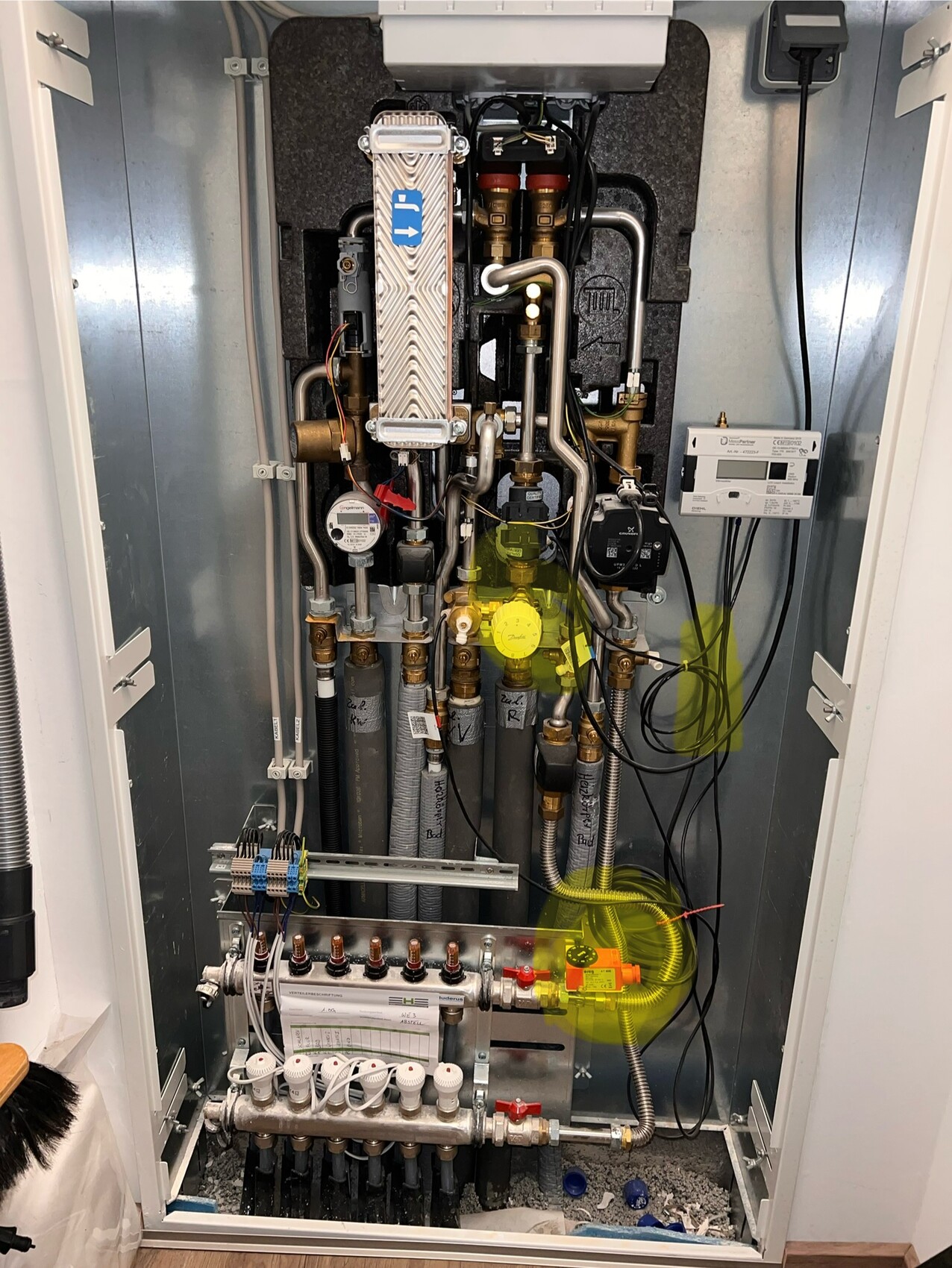

Hello, could someone please explain the meaning and function of the yellow-marked valves in the photo? My heating system is a Buderus Logamax Kompakt WS170 with an RC310 control unit. I have the following settings for my underfloor heating: heating temperature 20°C (68°F), setback +5°C (9°F). The maximum flow temperature is set to 35°C (95°F) and the return temperature to 30°C (86°F). The heating schedule is Monday to Sunday from 6:00 AM to 6:00 PM with setback. Boiler data: pump overrun time 2 minutes, control type: room temperature controlled, setback type: reduced, frost protection: outdoor temperature. In the photo, a Danfoss valve is highlighted in yellow, set to position 3, and next to the supply return line, connected to a pipe on the left, which I cannot read clearly—it looks like Zul V V or similar. My question is: Is this setting correct, or should the valve be opened further, for example to position 8? The Oreg contact thermostat is set to 40°C (104°F). Is this setting okay, or should it be adjusted to 60°C (140°F)? I would really appreciate an explanation.

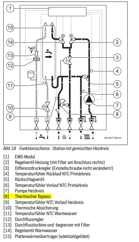

The Danfoss valve is a thermal bypass.
Functional diagram of a heating circuit station with a mixed heating circuit; thermal bypass highlighted.

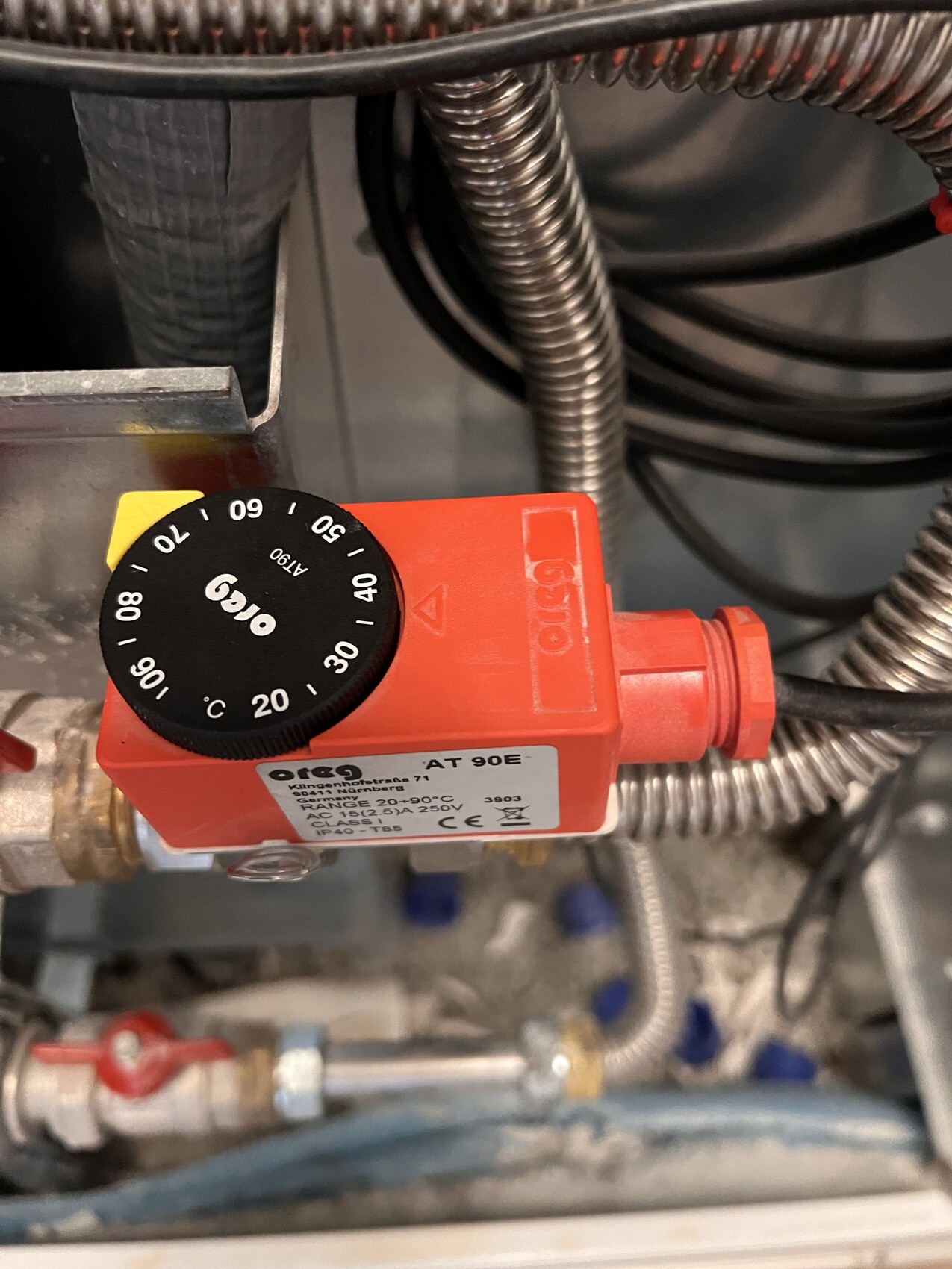

The orange component is an over-temperature sensor that monitors the supply temperature of the underfloor heating.

The little orange guy monitors my flow temperature of 35°C (95°F). Is the setting on the Oreg at 40°C (104°F) okay, or should it be set to 50°C (122°F) or 60°C (140°F)?
