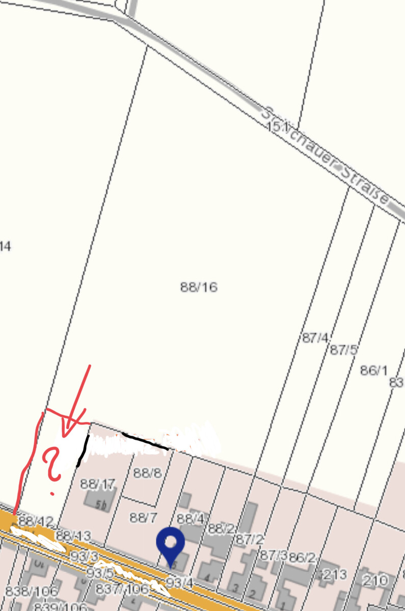

04849 is in Saxony. Try entering "Geoportal Saxony" into a search engine of your choice and browse around a bit. You’ll find a lot of useful information—especially about whether the land is designated for building and if there is a zoning plan.Thanks for your reply. I took a look, and according to the geoportal, there is only one cadastral parcel number, or is it because the survey is still missing as with 88/17? How can I tell if it is building land? I’ve attached a file showing what it looks like. The gentleman said we can build up to the height of 88/17. Those would be the neighbors with the bungalow. The width would be up to us; building up to the edge of the village is possible.
My questions now are: Is this really building land? After the survey of this section, will a separate cadastral parcel with its own number be created? 88/16 seems to be the parent parcel, and would the building plots be cut out of it following the survey?

Thank you for your reply. I took a look at it, and according to the geoportal, is there only one parcel number, or is it like 88/17 where the survey is still missing? How can I tell if it is building land? I’ve attached a file showing what it looks like. The gentleman said we can build up to the height of parcel 88/17 at most. Those are the neighbors with the bungalow. The width would be our concern; it could extend up to the town entrance.
My questions now are: Is this really building land, and after surveying the section, will there be a separate parcel with its own number? 88/16 seems to be the parent plot, and will the building plots be subdivided from this through surveying?
I hope this isn’t too confusingly written.
[ATTACH alt="73EC01F8-6E28-4057-9E15-3EF6844CBB84.jpeg"]37796[/ATTACH]At the bottom, go to Map Content => Planning => Land Use Plans; turn on the legend, if it’s pink then it is residential building area.P

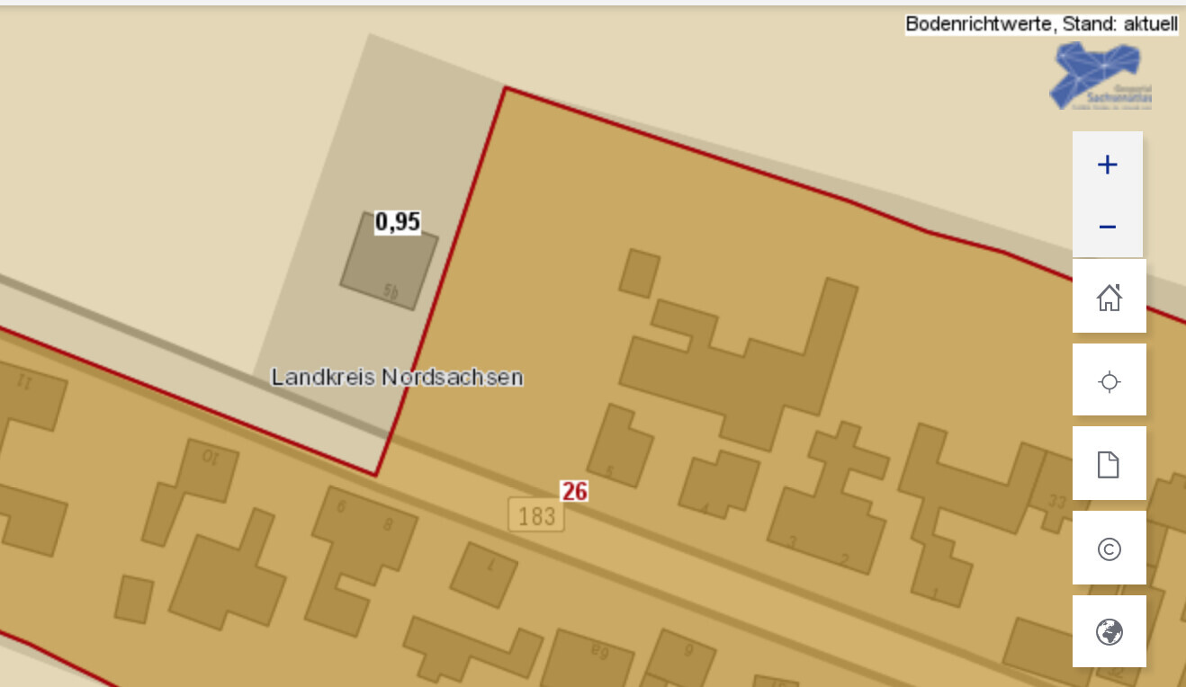

there you will also find the standard land value and whether the land is ready for building Thank you both, I have checked both sources and the result is that in the Geoportal and on Boris Sachsen the area is classified as agricultural land.
What surprises me is that on Boris Sachsen the neighbor’s property is not shown as building land, but on the Geoportal it is. I attached a comparison.
How and where can I next verify if it will be designated as building land and who makes that decision?
Why is the neighboring plot marked once as non-building land and once as building land?
