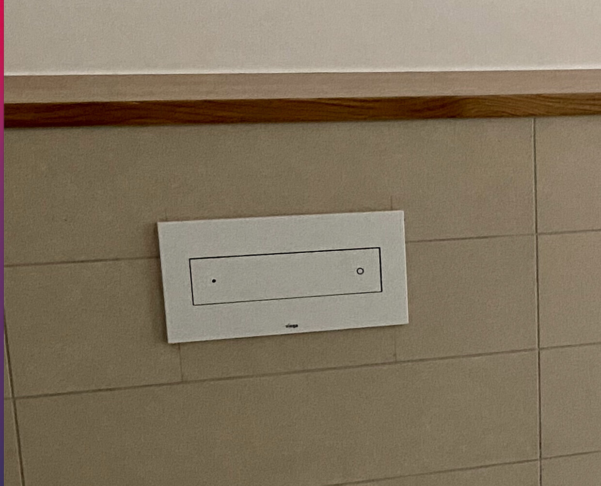

I am about to carry out the final inspection of our new build and have recently visited the construction site.
I noticed something concerning the tiles in the bathroom, but I am a complete layperson. Overall, the work is well done, but in my untrained opinion, the solution for the toilet flush area is not ideal or has failed. Since I have no knowledge in this field, I would appreciate some feedback before I address this with the builder.
I have attached a photo. You can see that the tile(s) have been cut into small pieces. Is there a better way to solve this?
Many thanks to the experts in the group.
HansGeorg67
HansGeorg67
HansGeorg6715 Mar 2021 18:55Would you not include this in the inspection report?
The lower section is already problematic. But in the upper section, you can also clearly see that the opening was cut too deep. The cuts are clearly visible there.
HansGeorg6715 Mar 2021 19:15Nordlys schrieb:
In practice, it’s simplest if the builder just installs a larger flush button, and that’s it. It can happen. Okay, I understand. But it still needs to be corrected...
