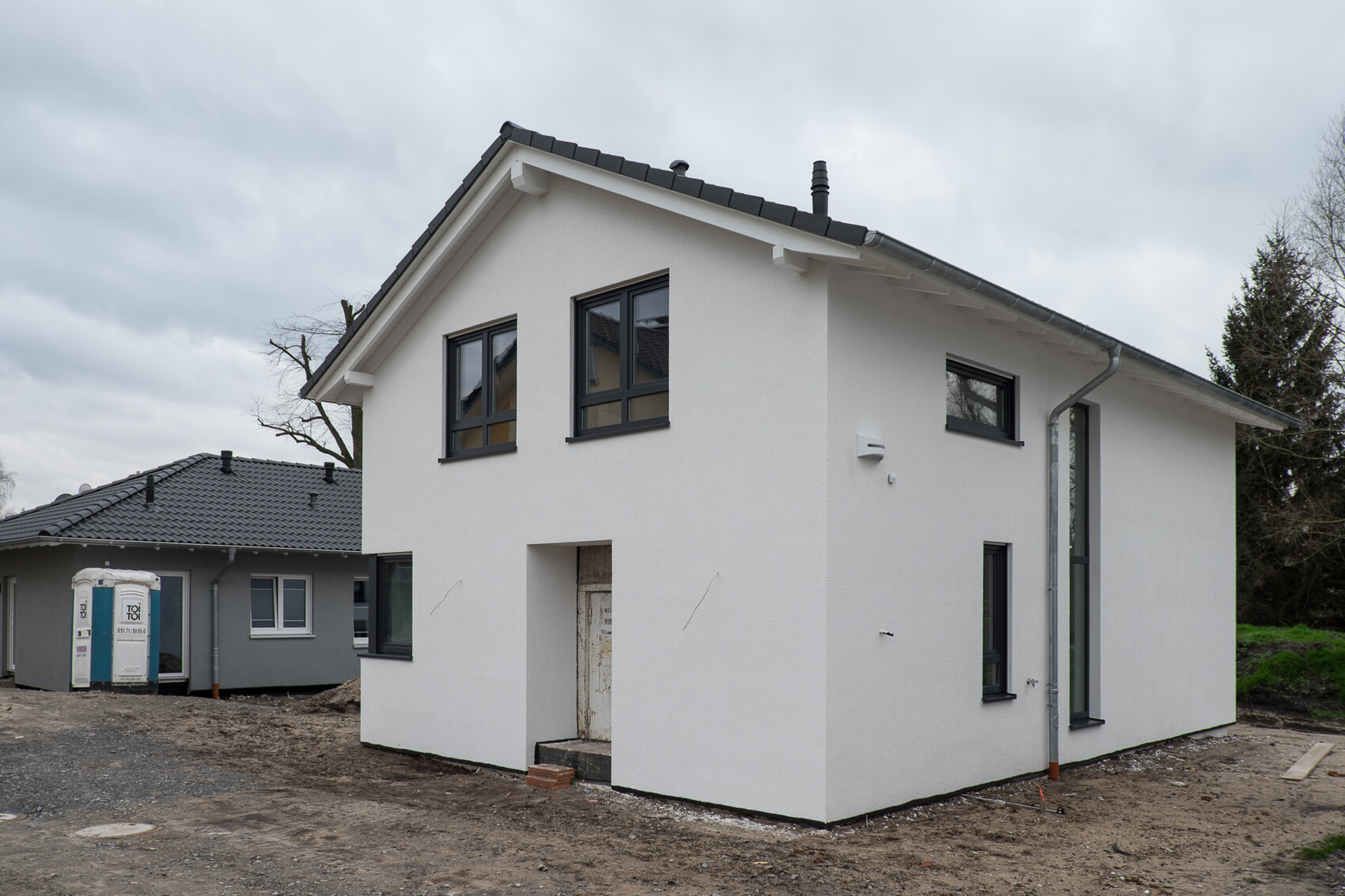

So mine look like this:
White modern house facade, two-story, gray window frames, construction site with porta-potty in the background.
As I said, I found these quite stylish... better than all the standard grids.

I have seen those somewhere as well. What are they called again? And are the supply and exhaust air separated, meaning do you need two of them?
Mycraft29 May 2016 11:36
Well, Vallox wall penetrations, you know...
Yes, you need one for each pipe, meaning one for the supply air and one for the exhaust air.

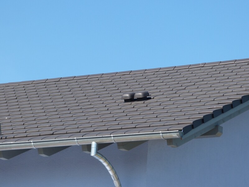

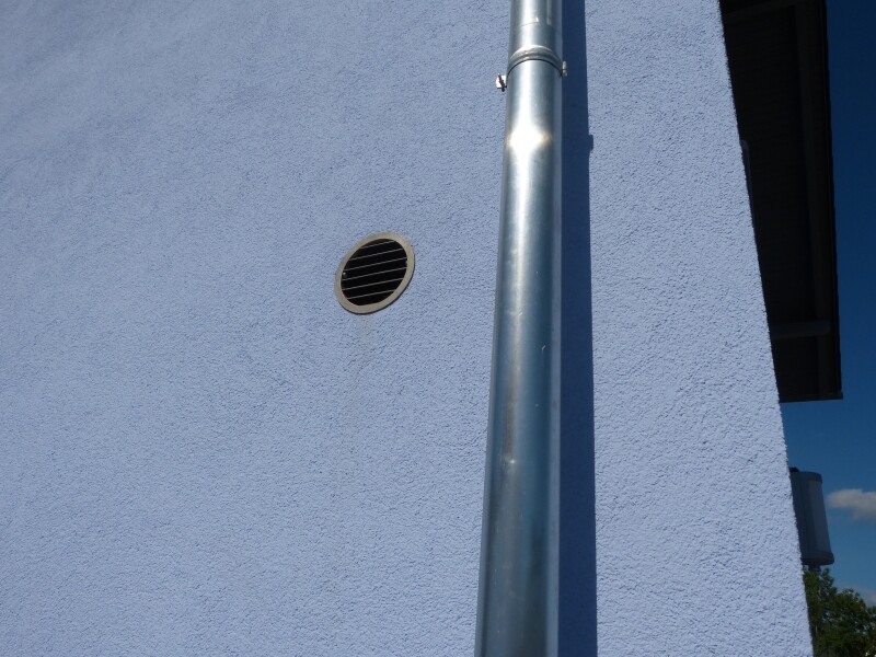

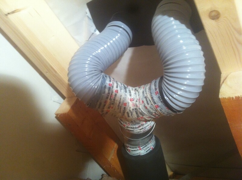

Outside air intake through the facade.
Exhaust air through the roof with original tiles.
Should be changed from 1x160 mm (6.3 inches) to 2x125 mm (4.9 inches).
