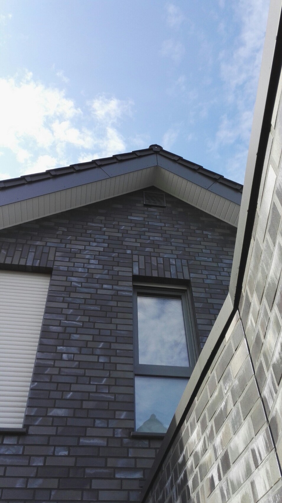

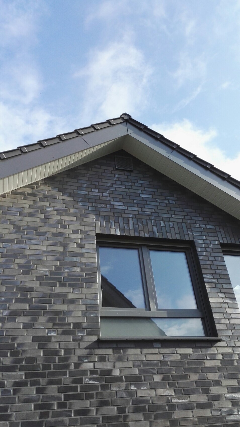

Sebastian793 Jun 2016 11:50S
Sebastian793 Jun 2016 11:54Yes, but if you powder coat it white, you won’t see anything either – in my opinion, stainless steel usually doesn’t look very good...
