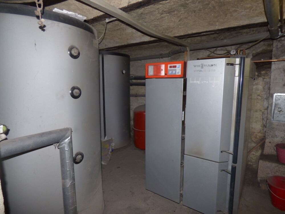

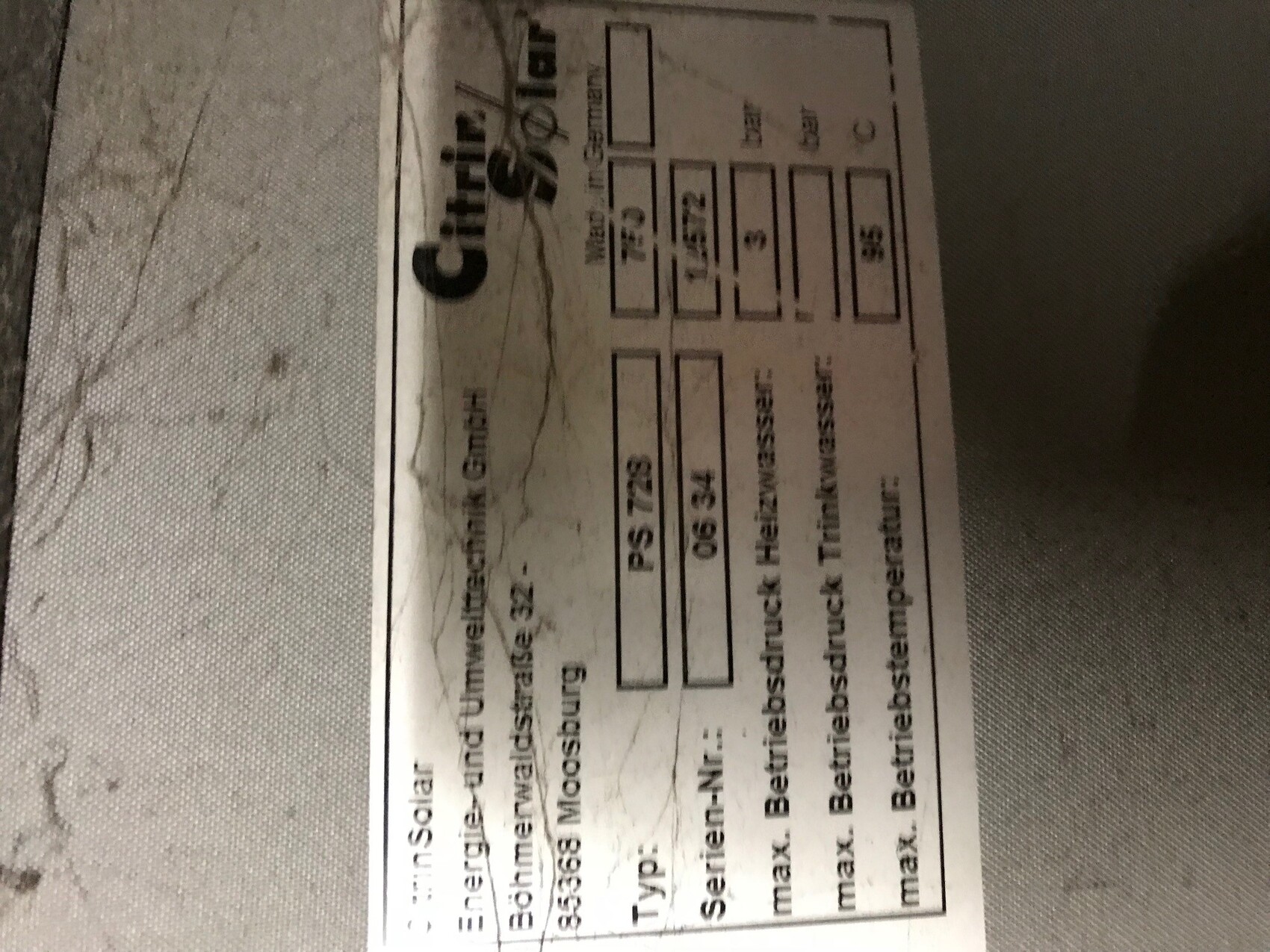

In our purchased house, we have a Viessmann Vitolig 200 wood heating system with approximately a 2000-?? liter buffer tank; unfortunately, I cannot determine the exact capacity of the buffer.
I can’t find the information on the nameplate (or is it 750 liters (198 gallons)?) and Google isn’t helpful either. See the attached image of the nameplate.
The system is from 2006 and heats an uninsulated house (the roof insulation is now being added) built in 1909 with about 180 square meters (1940 square feet) of living space.

William201730 Aug 2018 10:54That would also be my preferred option, but I haven’t found anything yet. However, I now know that the maximum is 728 liters (193 gallons) per buffer. The company Citrin investigated. Good customer service.
