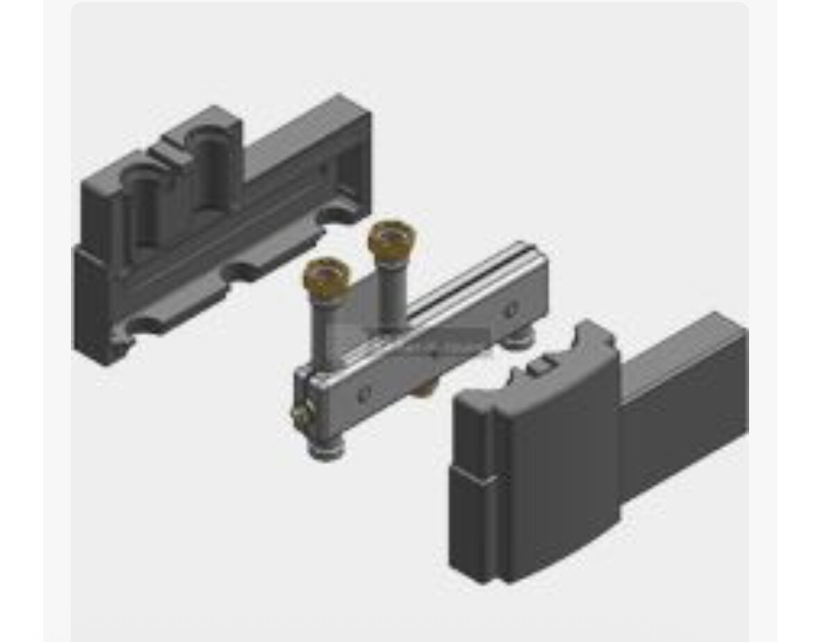

After the last feedback, the only remaining component is the hydraulic separator. However, here I have reached the end of my knowledge. When replacing and cleaning the pumps, the hydraulic separator was also drained. The first time, blacker water came out, but not typical sludge. The second time, during disassembly, it was relatively clear.
How can I clean this better, or is it possible to adjust the hydraulic separator? I hope for a solution or tip.
