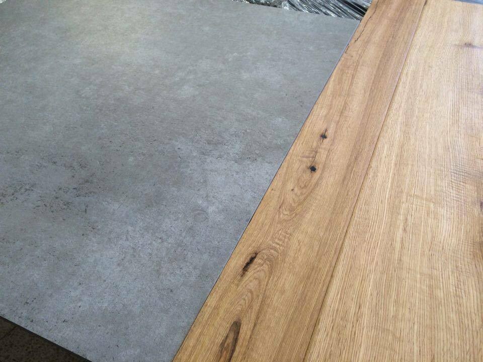

daniels8722 Apr 2016 14:51I definitely want a joint, just not those ugly wide baseboards that run along the top of the floor—I really dislike those! It’s only 16 sqm (172 sq ft) of parquet anyway.
Attached is a photo of the tile and the parquet. They should meet as discreetly as possible. I have no problem with cork strips or a silicone joint.
