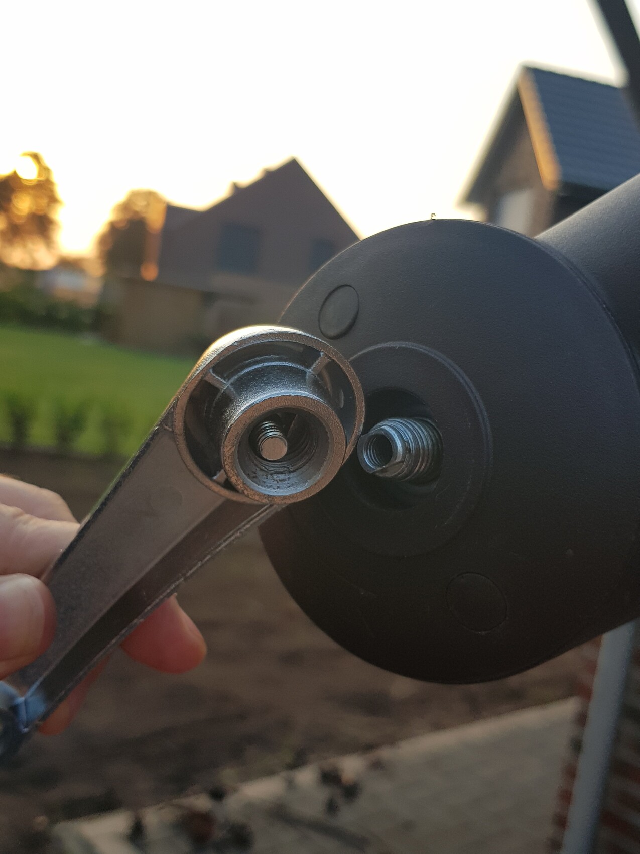

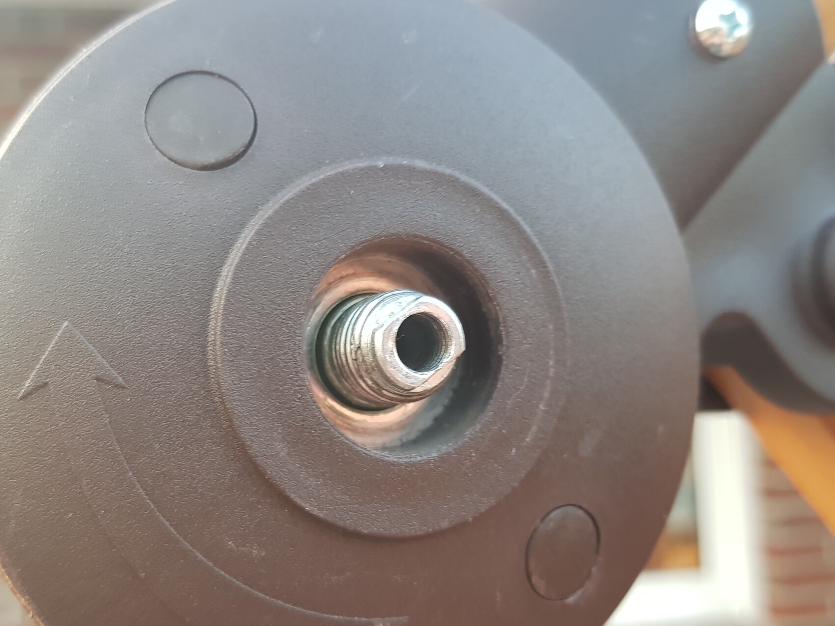

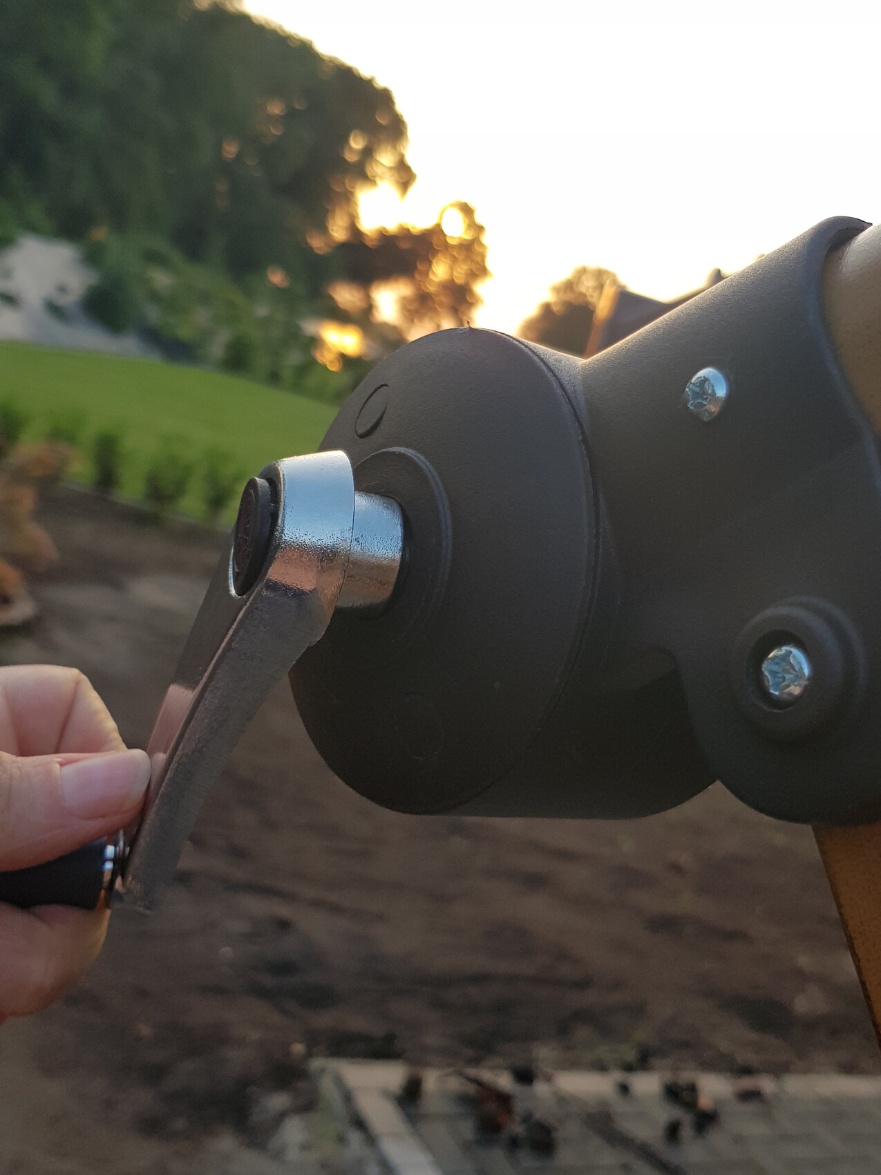

By the way, I’m still looking for such a canopy—do you think it could reach as far as Münsterland? :p I just took another look—the small screw is there, and it doesn’t even have a Phillips head. I can even visually reassemble the small parts to fit correctly. The problem is, I can push the small screw into its “thread” with just my finger—without a screwdriver. Unfortunately, it doesn’t hold at all anymore, I’m afraid. So even if we carefully screw it in, since there seems to be no actual thread, it will slip immediately when turned backwards, and then I’m left holding the crank again. The canopy stays open. Is there any way to close such a canopy without the crank?
Working on it – first I had to take the photos, then sync them to my computer. I don’t have the cable handy right now since I usually sync via drive, but because I hadn’t synced for a while, it insisted on uploading two-week-old videos first… 😀
Anyway, here are the pictures and thanks for your help.
I’ve also contacted the seller, but I’m not sure how to return it if I can’t close it properly.
