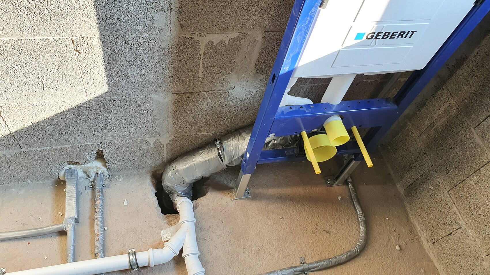

Attached are 2 pictures. One shows the plumbing rough-in. Maybe there’s a visible mistake in the pipe layout. The other shows the almost finished shower drain.

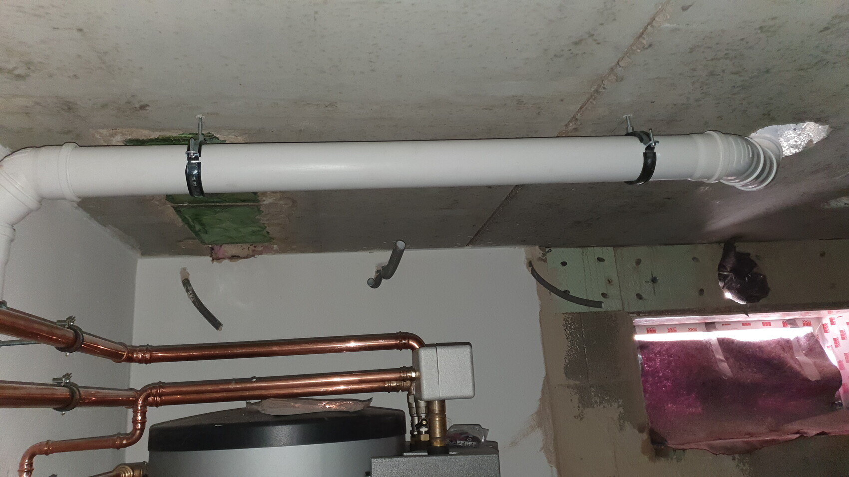

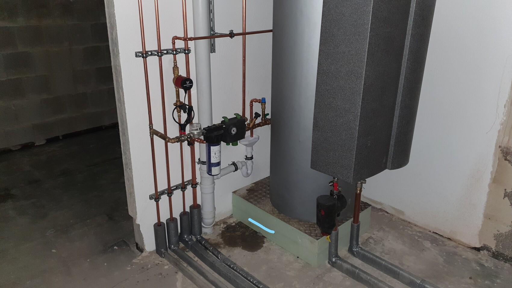

(Ventilation of the wastewater pipe, not the room air!) 🙂 Of course. I am obviously not referring to anything related to the ventilation system. I have now tried to trace the pipe routes using old photos. And if I understand this correctly, it seems that the lower bathroom and the upper bathroom each have two separate pipes that only join “underground.” That would obviously be a problem. I have attached more photos. The main bathroom upstairs is correctly connected. The one downstairs apparently is not.Tolentino schrieb:
