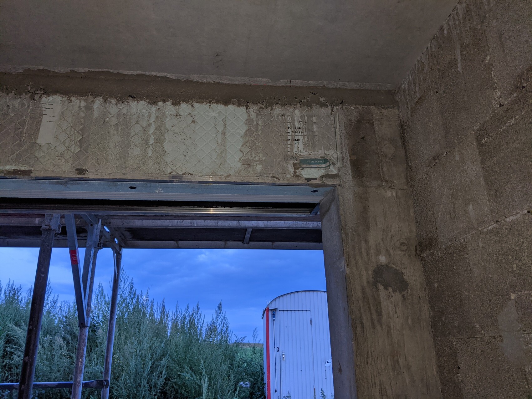

Our windows are now "almost installed," but unfortunately there are several deficiencies, which means replacement windows need to be delivered 😡. Unfortunately, issues like these are now affecting multiple trades, which is very exhausting and sometimes even discouraging. The quality of the general contractor (GC) does not live up to the initial praise.
Problem / Question:
Most of our windows have roller shutters with boxes installed inside the window reveal. The issue is that the shutter boxes are not deep enough and recess about 20cm (8 inches) from the interior wall. The plasterer is now supposed to plaster over this.
The plasterer suggests that this should be built up by 20cm (8 inches) so that the roller shutter box is flush with the interior masonry. Honestly, I have never seen it done differently and either didn’t notice before or was not informed about it.
Now we are faced with the decision of whether to have the lintels in the window reveals built up by 20cm (8 inches) with XPS insulation or similar materials for around €1500, or to simply have the recessed shutter boxes plastered as is, at no additional cost.
I have searched for pictures but found none; I believe this is rather unusual. The construction contract does not specify anything about this in detail. In my opinion, this is not correct or the roller shutter boxes should have been ordered with more depth so they would be flush with the interior wall ready for plastering... or am I wrong?
The GC claims this is often done this way...
Does anyone have ideas for a different (more cost-effective) solution or experience with this? It is hard for me to imagine the finished result having an additional 20cm (8 inches) of plastered surface inside above the window.
Unfortunately, I don’t have another photo right now; this one was taken at an angle from below and shows the lintel from underneath; the white area is the roller shutter box (to be plastered) and the brown parts are the window frames.
I hope I explained everything clearly, otherwise please ask.
