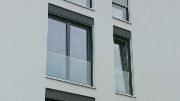

We only expressed the wish not to have bars in front of the windows. Have you ever considered installing glass fall protection instead of bars? That’s what we did since we didn’t want bars either.
Example image:
