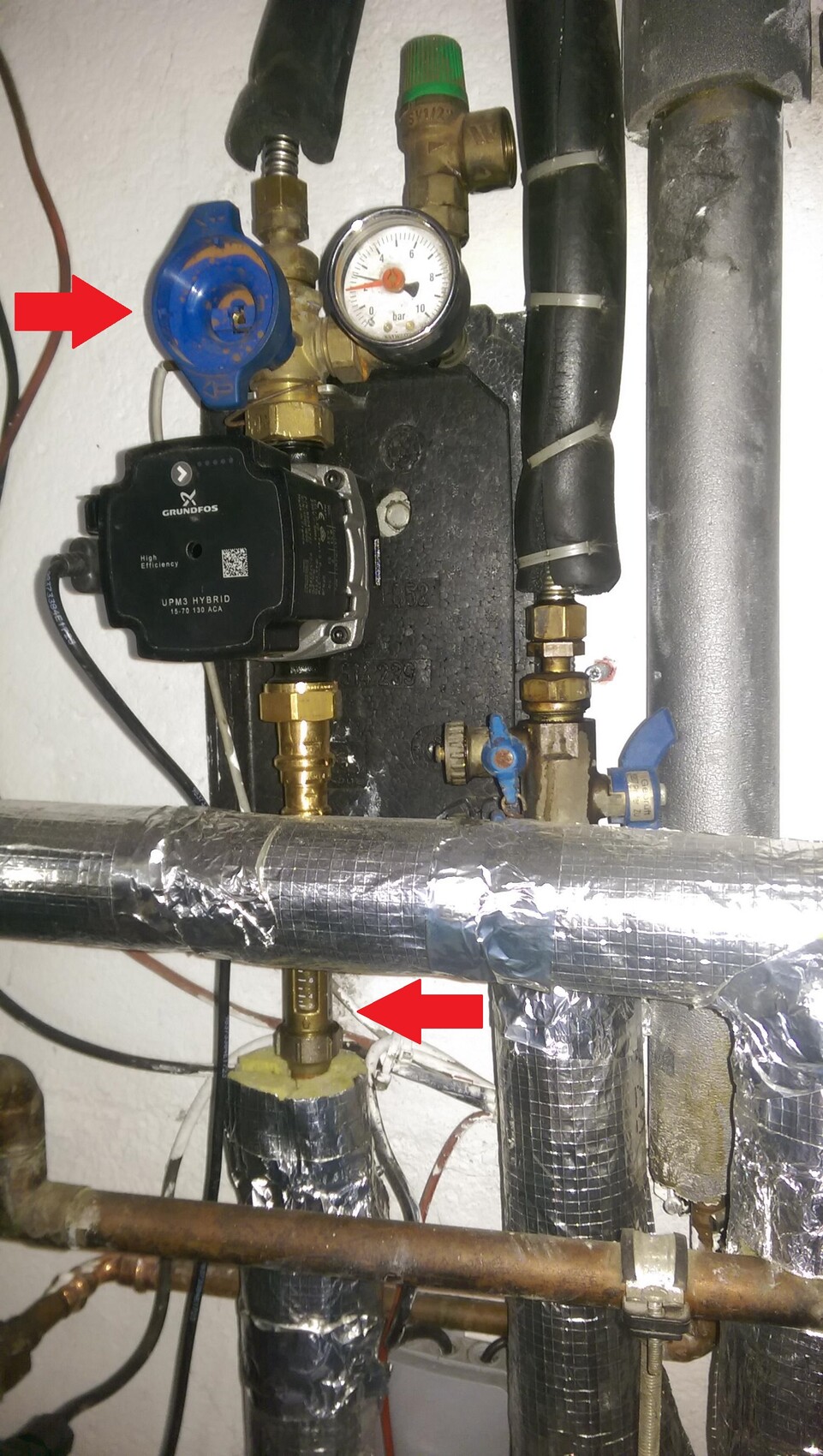

Good morning,
In the picture, you can see (the upper arrow) what I can turn. This causes the collector to cool down overnight. That’s how I performed the test.
The lower arrow points to the flow meter.
It is correct that the collector cools down at night in summer to prevent stagnation or damage. However, I noticed this on "cold" days when, after three days, I had to start heating and the collector showed 77°C (171°F), even though it was heavily overcast all day.
I just want to avoid heating my collector in winter because then it loses its value for me. On sunny winter days, I would like to get around 30°C (86°F) from the top and only heat the temperature difference.
You could also close the valve, but what if I’m at work and the sun suddenly comes out (you can’t really trust weather forecasts)? Then I would constantly have to open and close it.
I think there must be a way for the collector to cool down at night during summer but keep the temperature in the storage tank in winter without unintentionally releasing heat.
I only became skeptical when my installer said that it couldn’t be possible.
