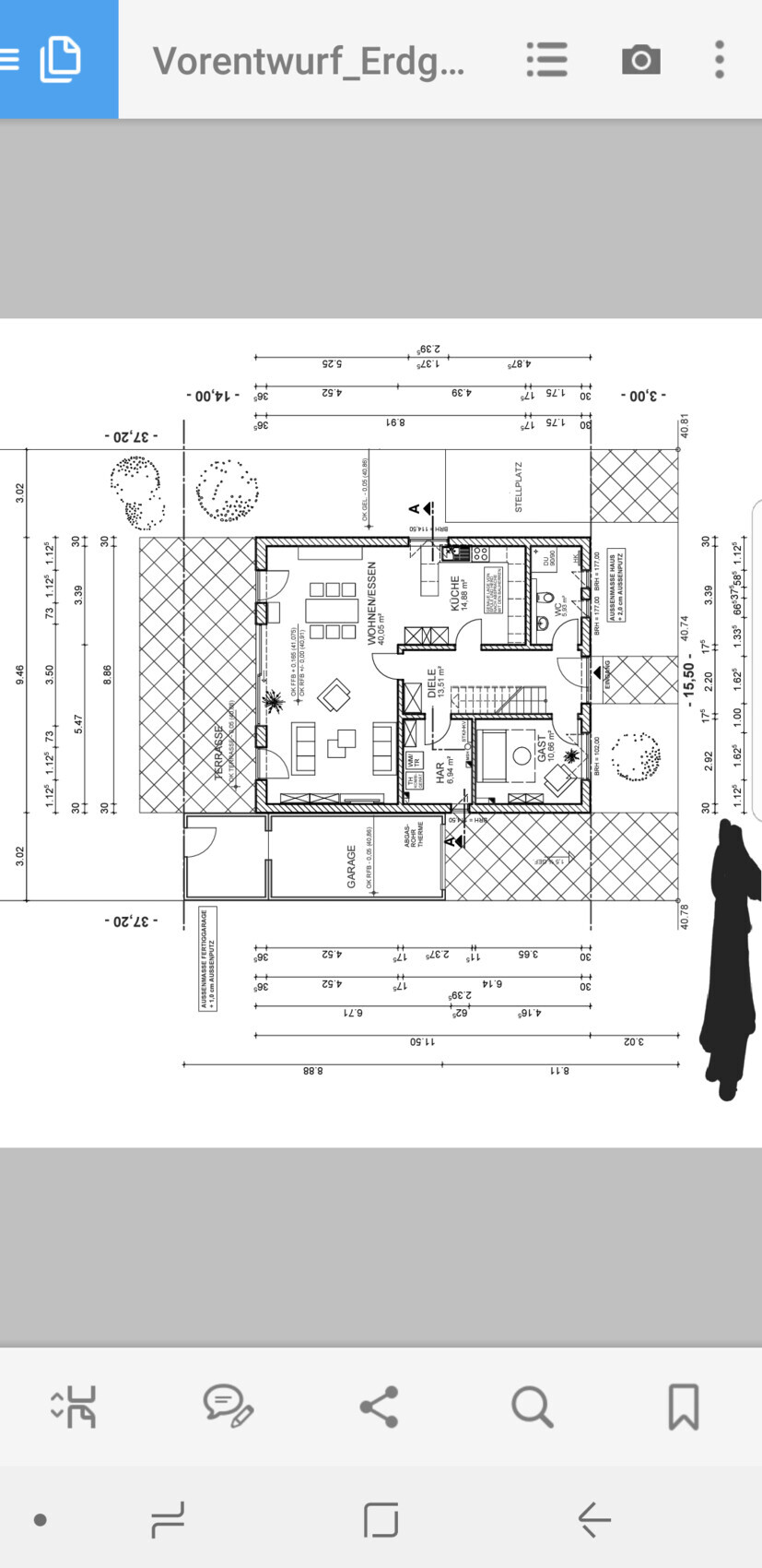

We want a straight flight stair. But how long should it be to ensure it is comfortable and easy to use?
There is a height difference of 150 cm (59 inches) — the height of the rooms on the ground floor — plus the height of the ceiling construction that needs to be overcome.
What angle of inclination is generally considered comfortable for stairs?
Our planner has allocated 330 cm (130 inches) for the stair length.
What do you think about that?
