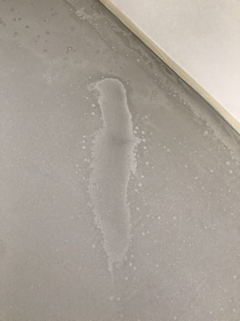

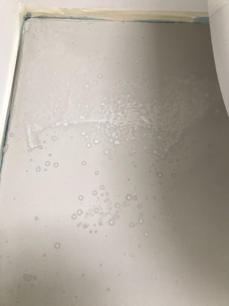

Hello
My flooring installer applied a cement-based leveling compound twice. Now there are some very unsightly spots. The floor has not yet been sealed or sanded. Will sanding remove these stains, or would it be better to apply a primer first and then level it again? Thanks for your feedback

25 Aug 2017 23:05
I don’t see anything unusual. Just file down any small burrs, vacuum, and apply adhesive tape. There are just cement residues, so what? That’s always the case. There will be a covering on top anyway. Or didn’t it cure properly? Karsten

26 Aug 2017 08:28
I don’t see any special issues here either...
winnetou78
26 Aug 2017 08:50
So, when it is mentioned that the floor will be sanded and sealed, I assume that the floor is intended to remain as it is, and it is not just a leveling compound or something similar.
Otherwise, it obviously looks awkward.
Nordlys
27 Aug 2017 08:26
Hmm. Is that going to be covered? Or not?
Tom1607
27 Aug 2017 09:07
These are typical drying marks that cannot be prevented. However, they are only superficial. Once the floor is sanded, they will disappear. Applying filler again is pointless because the same issue will occur.
