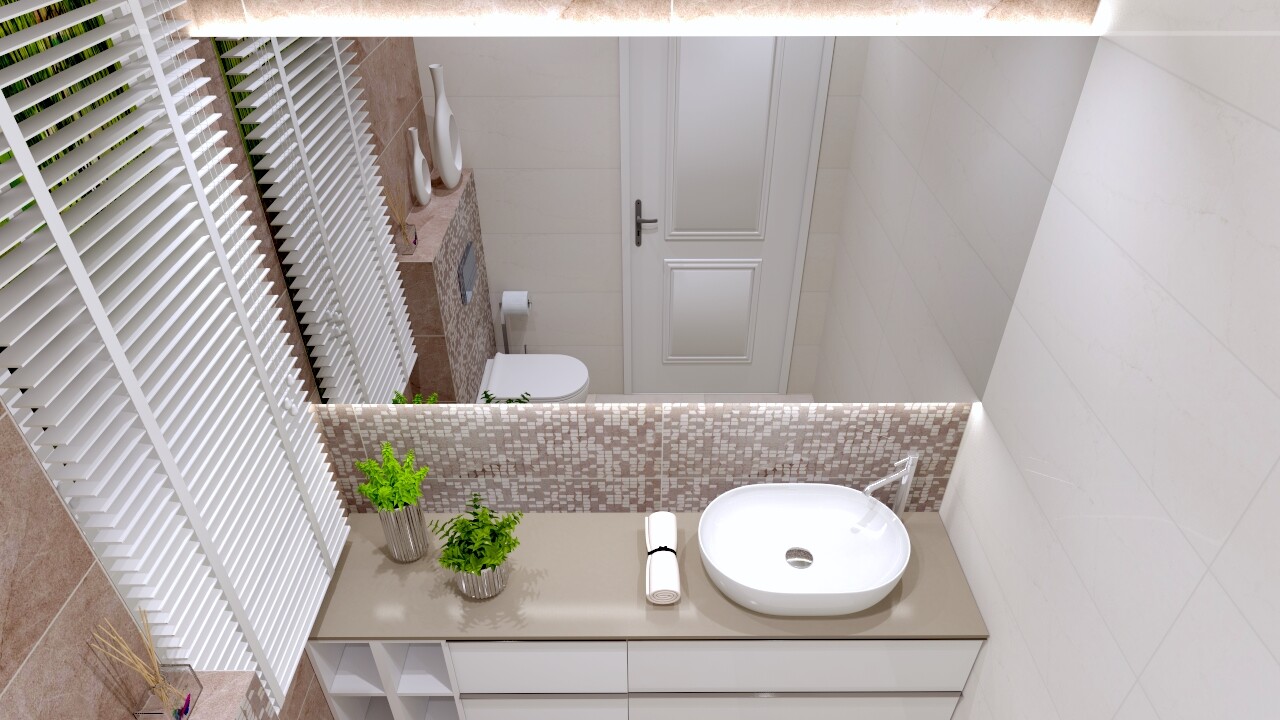

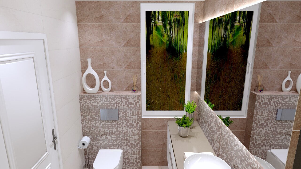

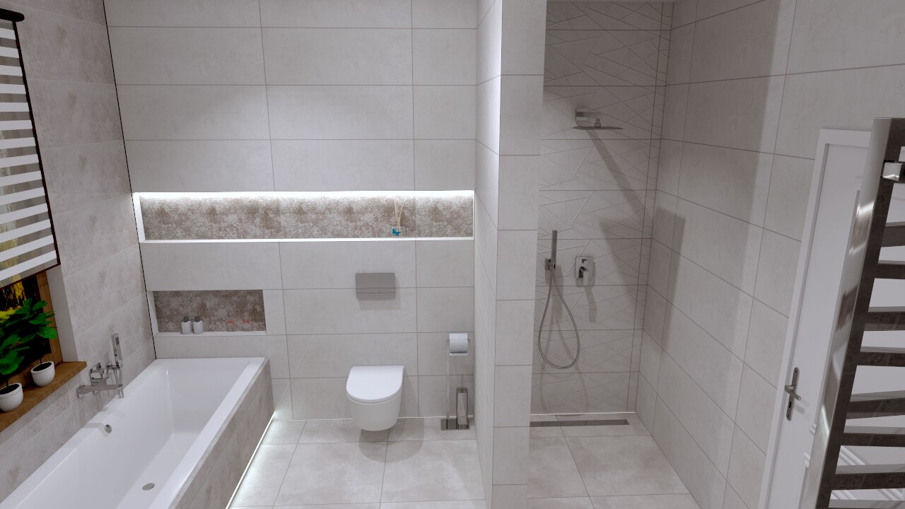

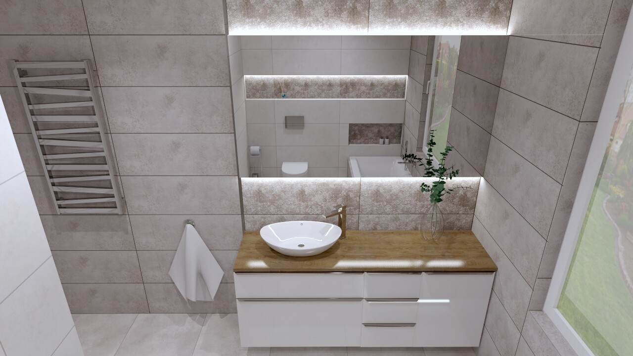

SumsumBiene schrieb:
Have you thought this through carefully?
We are dealing with this issue now in the house we bought... floor-to-ceiling tiling really gives it a slaughterhouse feel
Yes, we did, and for a very long time 😎 Attached are the planned bathroom designs.
Modern bathroom view with wooden vanity, round basin, illuminated mirror, bathtub, and window.
Modern bathroom: bathtub on the left, toilet in the middle, shower on the right, windowsill with plants.
Modern bathroom with round white sink on countertop, mosaic wall, and two plants.
Bright bathroom with window overlooking a forest path, toilet, washbasin, plant and decorative vases; mirror.
Han Solo
30 Apr 2022 06:15
Modern slaughterhouse, looks great 🙂
