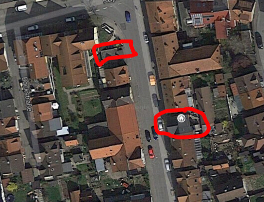

A brief background: I own a fully renovated historic building from 1920. The garage is a prefabricated unit, located separately across the street from the property, see image.
Since I have a plug-in hybrid vehicle and plan to renovate the garage (adding an electric gate opener, lighting), I will need electricity there in the future.
My question now is what would be more cost-effective or practical—or even possible: a house connection or a solar power system?

Personally, I believe this investment will not be cost-effective.
Point 1: The installation costs.
Point 2: It is questionable whether enough electricity is actually produced in winter to properly charge the car/batteries. For example, we have a 5.5 kWp system on our house. In December, the system produced only minimal amounts – the feed-in was just over 30 kWh, and self-consumption was also low. This is not an isolated case in winter, as shown by the fact that in January, we only reached about 90 kWh.
Point 3: As far as I know, prefabricated garages have a limited lifespan. Could it happen that the garage might need to be demolished before the system even starts to pay off in any way?
Do you have the option to use a parking space directly at the house?
Then install the system on the house (ideally increasing the system size), charge your car at the house, and use any remaining power for your home or feed it back into the grid.
You really need to have a strong environmental commitment for a photovoltaic system on the garage.

wrobel schrieb:
If the top of the image is north, I would first consider the shading.
You are absolutely right. I hadn’t paid any attention to that at all.
