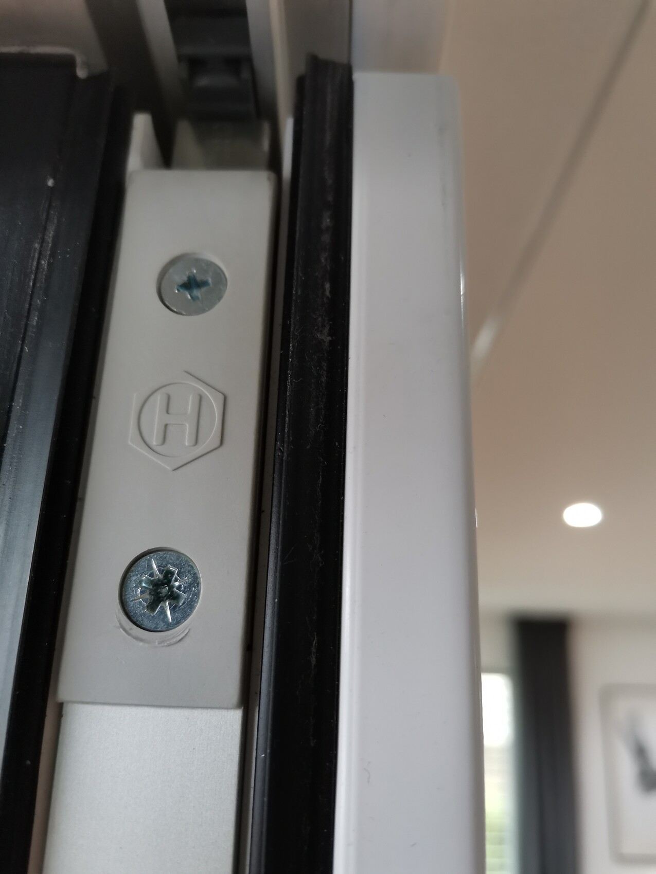

ivenh0
24 Nov 2020 12:24
Tarnari schrieb:
I wouldn’t know how to implement that with a traditional sliding door. Do you have any ideas? Where could I place a second contact there?
This is how it works with our sliding door. The contact switches immediately to "open" as soon as the handle is unlocked, even if the sliding door doesn’t move at all.
It’s the same with standard doors. Handle down = closed, anything else means open.
Mycraft24 Nov 2020 12:33
Yes, that makes perfect sense. With only one contact, you can represent just 1 and 0. An additional contact provides two more states. In other words, it allows differentiation between being open but closed against something, and being fully or partially open.
Tarnari24 Nov 2020 12:53
ivenh0 schrieb:
This is the case with our sliding door. The contact switches immediately to open as soon as the handle is unlocked, even if the sliding door does not move at all.
It’s the same with the regular doors. Handle down = closed, anything else is open.
Where is the contact located on your door? In the handle or the frame?
I
ivenh0
24 Nov 2020 13:00
Tarnari schrieb:
Where is the contact point for you? On the handle or the frame?
If that is the contact point, then it is at the very top of the door and frame.
Close-up of a window fitting with two screws and an H-logo on a gray plate
Tarnari24 Nov 2020 13:01
ivenh0 schrieb:
If that is the contact, then it’s located at the very top of the door and frame.
[ATTACH alt="IMG_20201124_125838.jpg"]53966[/ATTACH]
And does it really only detect the handle being operated? Well, the door is slightly lifted or lowered in the process. I wouldn’t have thought that would be enough.
