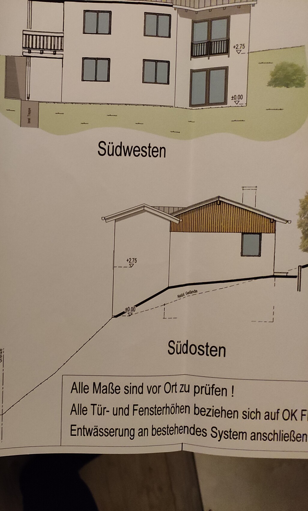

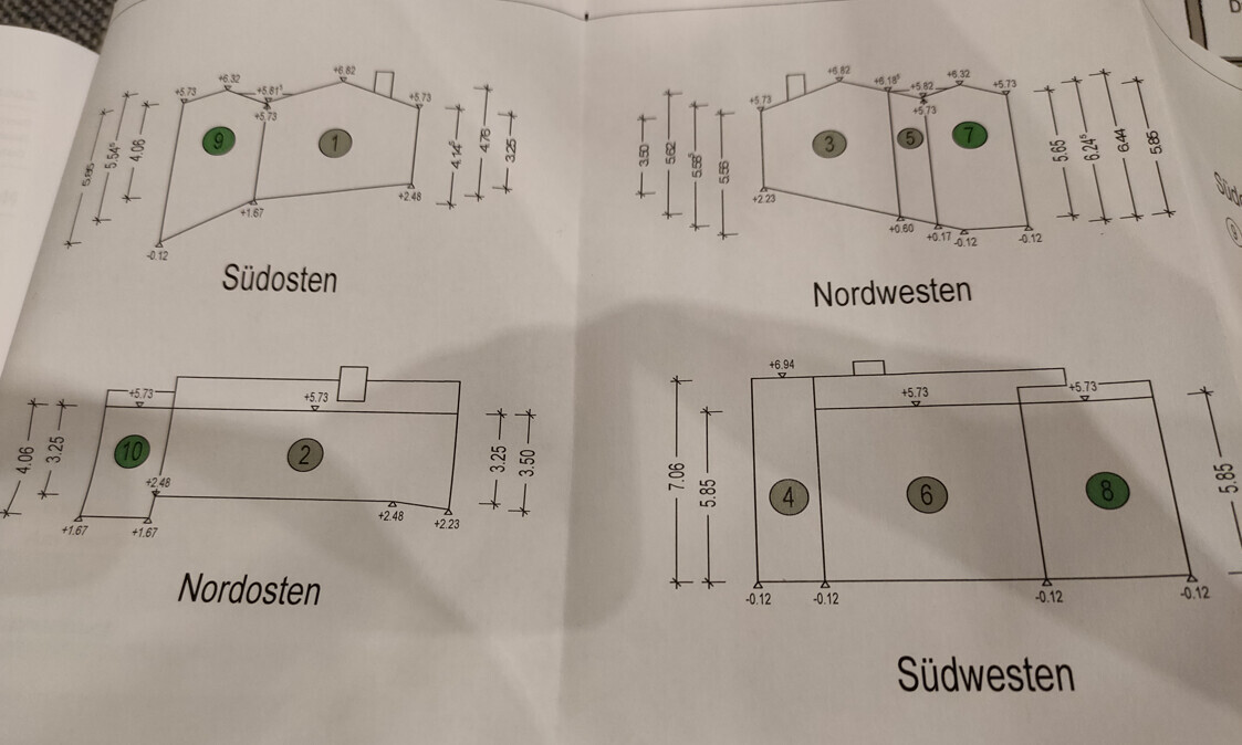

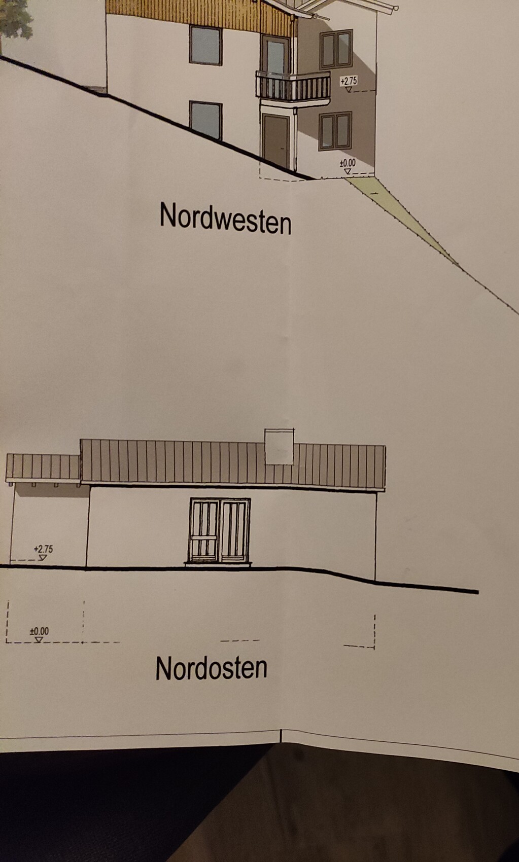

Myrna_Loy28 Jan 2022 11:51As a layperson, I have reviewed the complete documents again. The cited height (5.85 m (19.2 ft)) in the rejection is taken from the setback plan – is this the relevant reference? The maximum allowed wall height is 5.5 m (18 ft). In my non-expert opinion, the wall height of the extension is not higher than that of the existing building (5.30 m (17.4 ft)), unless the fill, slab, etc., are also included. Of course, this kind of thing always happens on a Friday :-(
I know this is not legal advice, but perhaps some of you have had similar experiences…
sveba schrieb:
In my amateur opinion, the wall height of the extension is not higher than that of the existing building (5.30 m (17.4 ft)), unless the fill, slab, etc. are included. From my less amateur perspective, I notice in the "northeast" drawing a change in height, which suggests that the terrain shown is not original; height limits usually refer to the natural ground level (exceptions are rare, but I have seen this in Baden-Württemberg).
