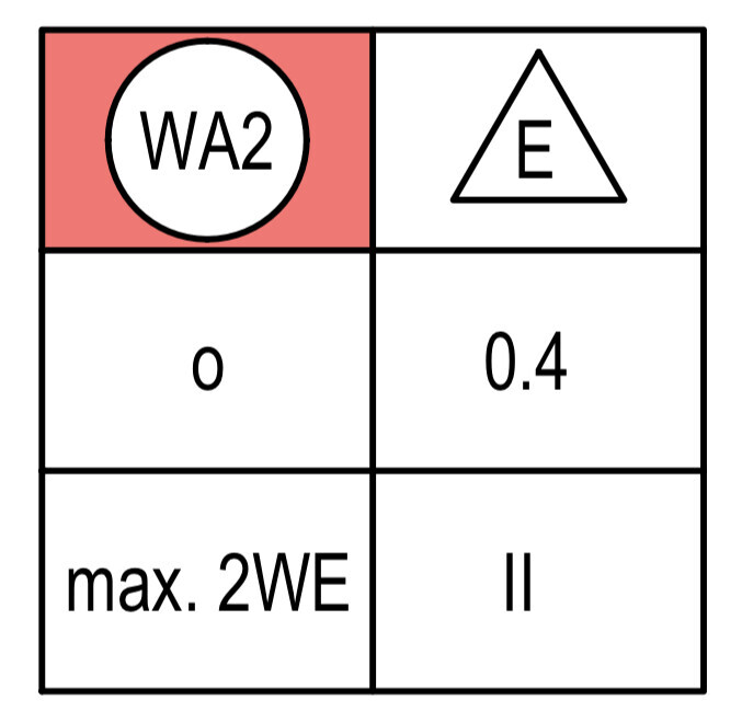

Zoning Plan / Restrictions
Plot size: 450 sqm (4,844 sq ft)
Slope: Yes, north-facing slope (from the street toward south-southwest) with about 1.5 m (5 feet) elevation within the building envelope (1 meter (3 feet) within the planned footprint) rising
Floor area ratio (FAR): ?
The zoning plan does not provide this information
Building area ratio (site coverage): 0.4
Building envelope, building line and boundary: 19.5 m (64 feet) wide (street side), at the rear 17 m (56 feet) wide and 14 m (46 feet) deep
Edge development: Yes
Number of parking spaces: 2 for the main unit and 1 for the secondary apartment
Number of floors: 2.5
Roof type: Gable roof
Architectural style: Traditional
Orientation: Ridge runs from west-northwest to east-southeast
Maximum heights / limits: Maximum ridge height 9.5 m (31 feet) above finished ground floor level (this may exceed the reference street level by max. 0.5 m (1.5 feet))
Other requirements: Side setbacks 3 m (10 feet), setback from the street 3.5 m (11.5 feet)
Architectural style and building type: Simple, economical building form with a gable roof
Basement, floors: Basement with secondary apartment, total 2.5 floors

Kristijan
10 Feb 2022 21:50
askforafriend schrieb:
I’m completely lost—could you help clarify things for me? Your development plan shows a plot ratio (site coverage) of 0.4, but I don’t see anything about the floor area ratio (FAR)?
I’m afraid that in my ignorance I caused your confusion and the previous debate about the floor area ratio. I simply mixed up plot ratio (site coverage) and floor area ratio. We have a plot ratio of 0.4 and no floor area ratio specified. Sorry about that. Yesterday, @11ant already pointed out that the plot ratio should be indicated in the plan. Anyone who can read it clearly has an advantage.
By the way, where did you get our development plan from?

askforafriend10 Feb 2022 22:08
Kristijan schrieb:
I’m afraid that out of my own ignorance I caused confusion regarding your train station and the earlier discussion about the floor area ratio. I simply mixed up the site coverage ratio and the floor area ratio. We have a site coverage ratio of 0.4 and did not specify a floor area ratio. Sorry.
Yesterday, @11ant already pointed out that the site coverage ratio should be indicated on the plan. Anyone who can read it clearly has an advantage.
But tell me, where did you get our zoning plan from?
Well, I’ll leave it up to you now whether you want me to share here how I got the zoning plan 🙂
Kristijan
10 Feb 2022 22:16
Well, I'll leave it up to you if you want me to explain here how I obtained the zoning plan 🙂
Not necessary. I’m the fool who found it. But now I can’t edit anymore.
