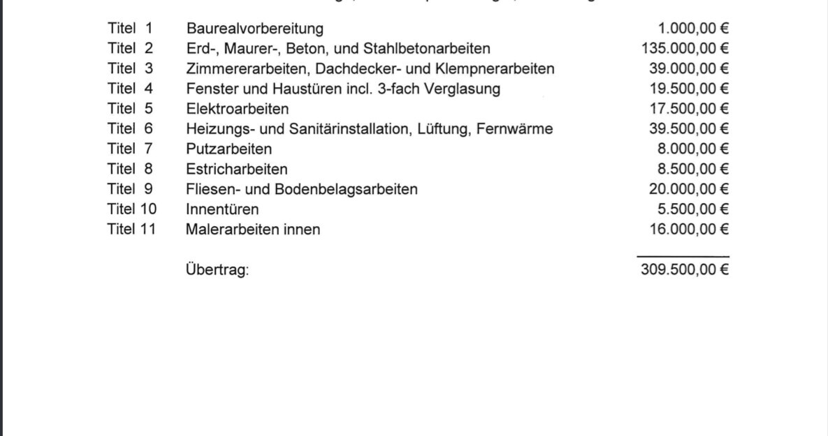

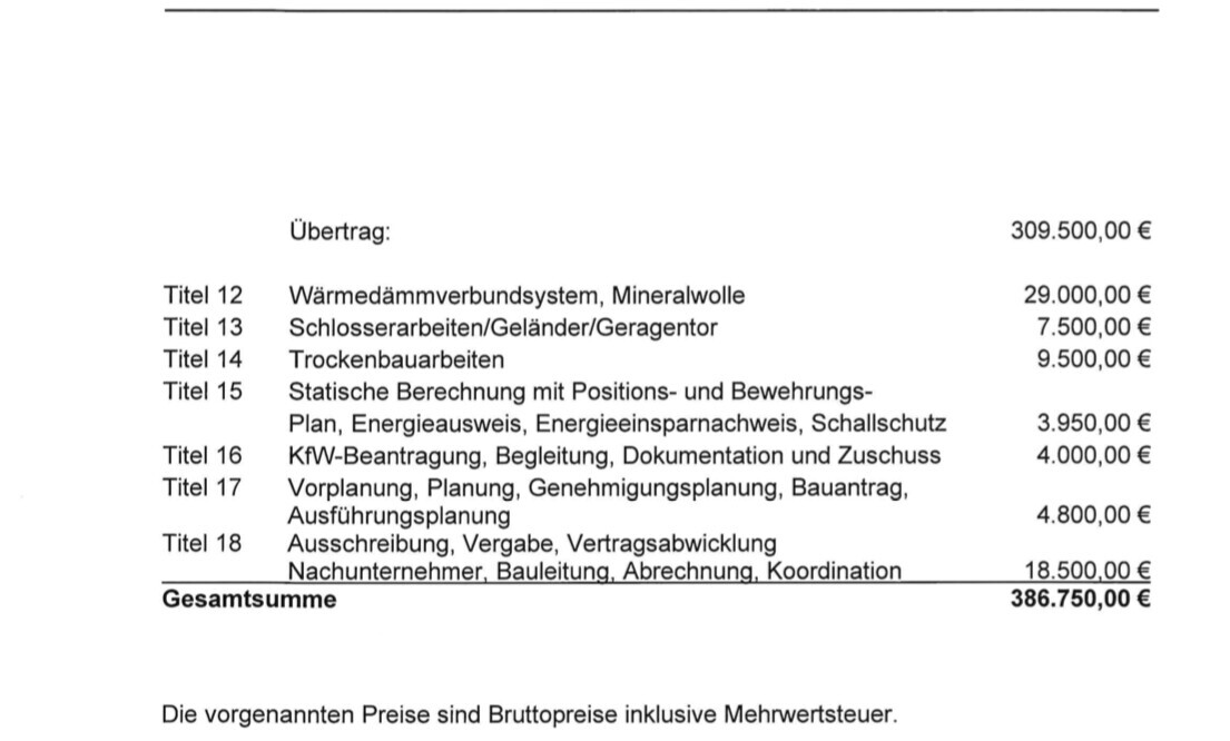

Cost estimate according to architect/planner: according to planning firm: approx. €386,000 (without land (€78,000), landscaping, and kitchen – I could share the cost breakdown if allowed?)
Personal price limit for house including fittings: excluding additional costs and land: €400,000

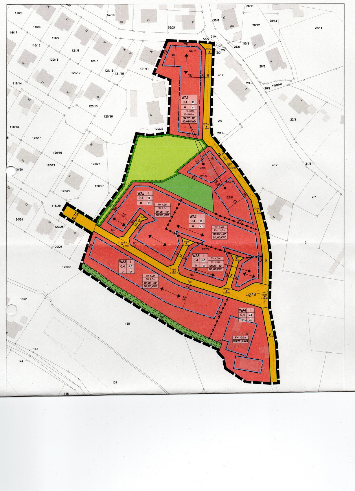

Maximum height limits: total height 6.20m (20 feet 4 inches), façade height 11m (36 feet 1 inch)
additional requirements: city villa not allowedIt probably doesn’t say that exactly like this in the building regulations / planning permission (?) https://www.instagram.com/11antgmxde/

€386k? What exactly is included in that? Please post a detailed cost breakdown.I will post the cost breakdown shortly.

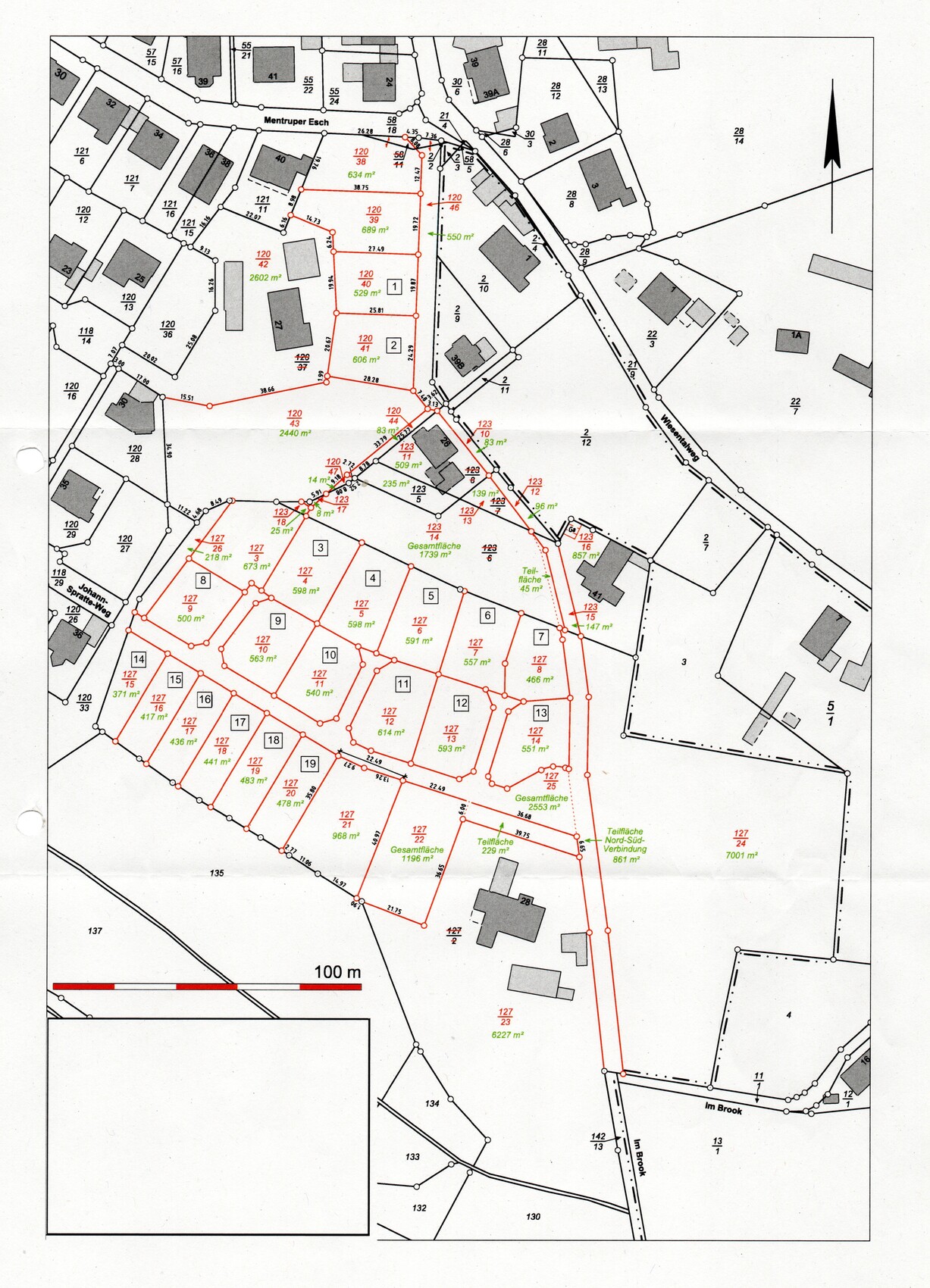

That is probably not what the building plan allows (planning permission)?No, it was denied upon inquiry.
I’ll upload a second floor plan soon (this one is from an architect)! Also, additional images with more measurements, etc.

And as haydee already pointed out, swapping the living room and kitchen would be a good idea.Okay, since the plot is on a south-facing slope and the sun’s path is such that the kitchen gets the morning sun and then it moves over the dining room towards the west, we planned the kitchen and living area to face south where there’s also an unobstructed view of the adjacent forest.
I’ll upload some more pictures showing the location of the house. Our plot is number 6!!
