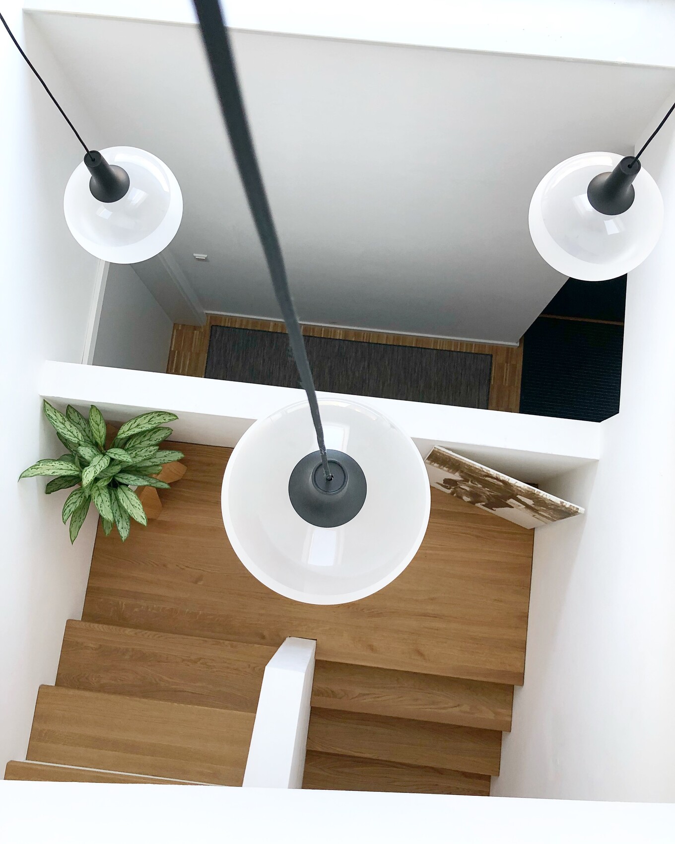

We basically like the design a lot, but I’m not happy with the staircase situation on the upper floor. Downstairs there is a landing staircase that then continues as a quarter-turn staircase (due to limited space) leading up to the attic. I don’t find this combination visually appealing. We tried planning a straight staircase, but didn’t make much progress. We’re not big fans of winding staircases, and this seems to be the biggest challenge right now.
The staircase should also not be located in the entrance area or visible from the entrance.

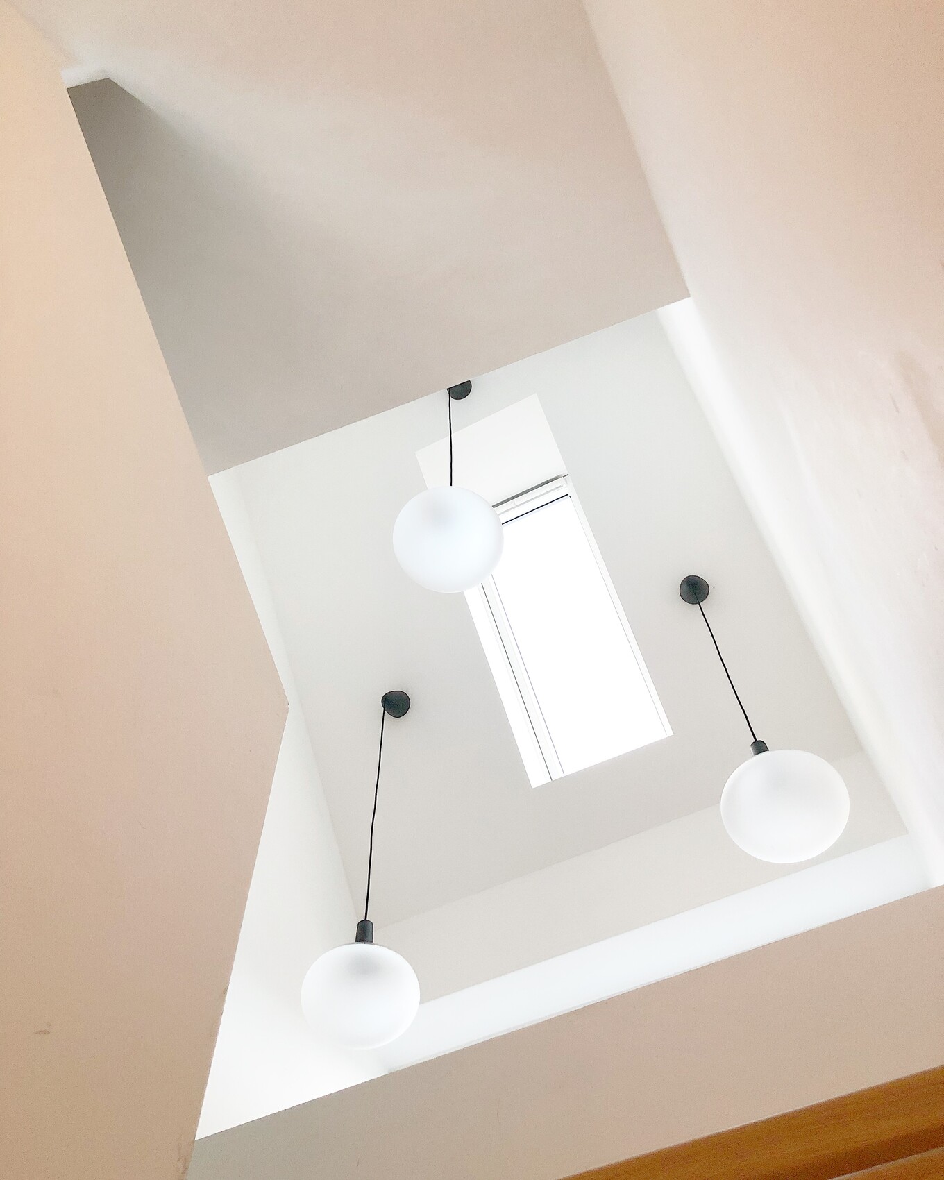

Both staircases are open to the back (does that make sense?). There is an open space in the hallway reaching all the way to the top. A brick parapet (or railing) is planned there.
The staircase should be accessible from the opposite direction.
