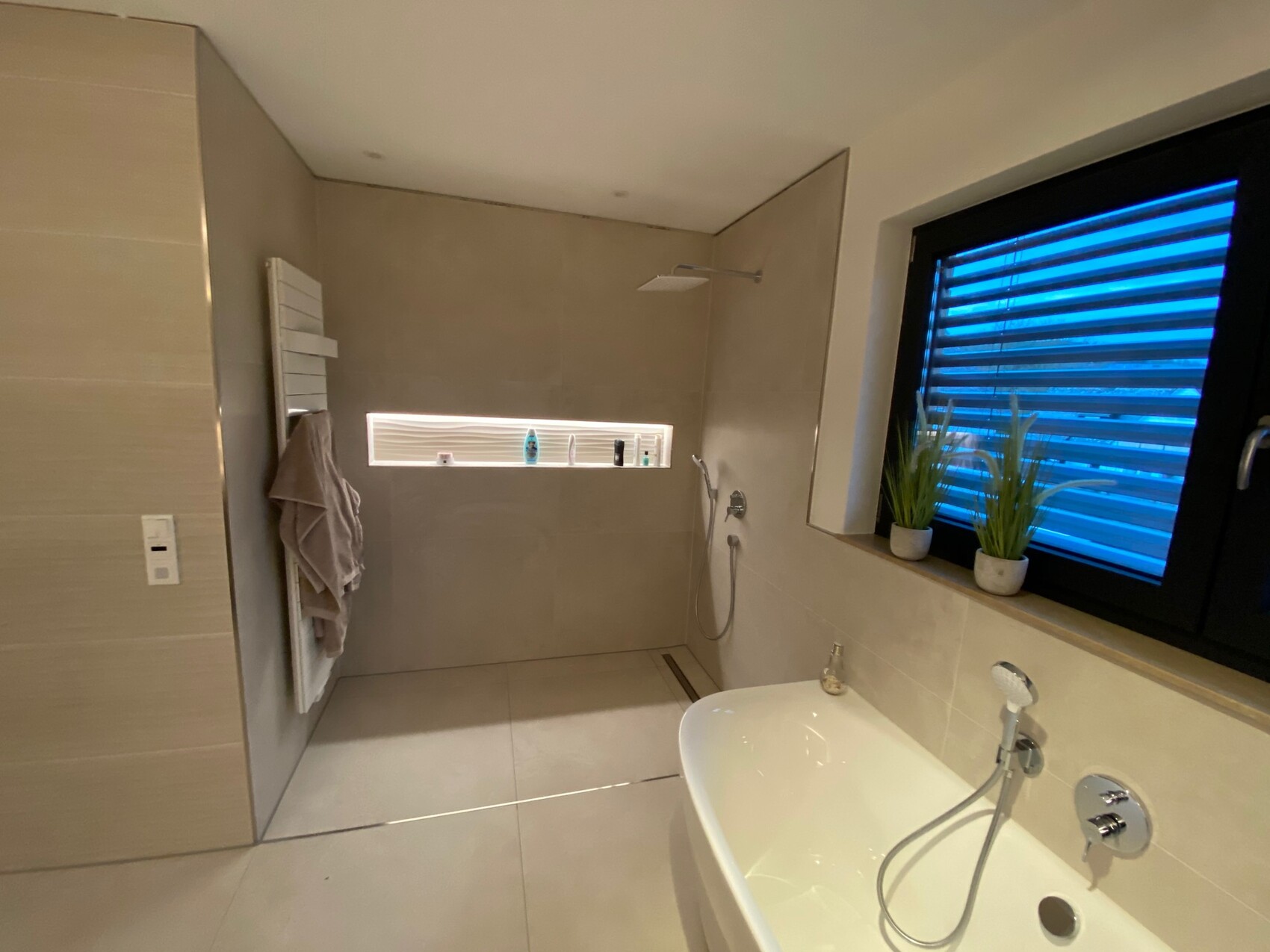

Alessandro15 Sep 2020 08:50Brainstorming schrieb:
Did you install the glass panel yourself or have it done? Is the track on the floor the glass guide? I had it installed. The glass panel is only held by the tracks on the floor and the wall. No additional stabilizer is needed.
But apparently this only works up to a length of 140cm (55 inches).
manohara schrieb:
@Alessandro
I have two questions about your photo:
1. You mentioned "glass stabilizers mounted from the ceiling."
But there is nothing mounted on the ceiling in the picture?
2. There is a visible silver strip all around (except on the ceiling side and below the window on the right), but no visible end of a glass panel? The glass panel and its fixing cost a bit more, but therefore no stabilizer is required.
That’s probably why the model is called "Duscholux AIR."
What do you mean by the end of the glass panel?
Alessandro schrieb:
What do you mean by the edge of the glass pane?When a pane ends in open space, you can see the edge. I don’t see anything in the photo...
Alessandro15 Sep 2020 09:02Alessandro schrieb:
By the way, I have a total length of 210cm (83 inches). 140cm (55 inches) glass wall, 70cm (28 inches) passage.
Hello Alessandro, I have a question about your really great shower: how *deep* is it?
Alessandro8 Nov 2021 08:03Hi,
the shower board is 1.10m (3 ft 7 in) wide......
