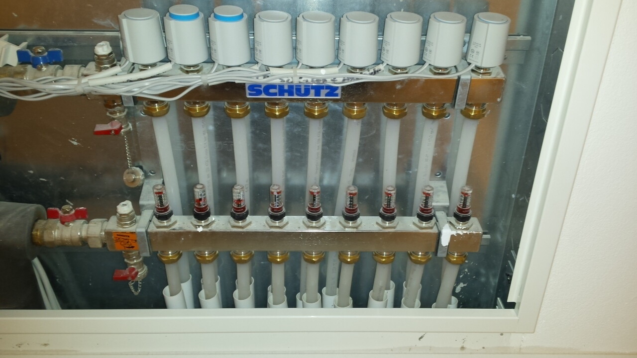

oggear51 schrieb:
that the flow rate is set the same on every loop, meaning fully open, then it is probably clear that no hydraulic balancing has been done, right? It is very likely that this assumption is correct.So, after I sent the heating engineer a letter, he came today and "fixed" all the issues. He claimed to have completed the hydraulic balancing in about 20 minutes. You don’t have to be a professional to know that this can’t be done properly in such a short time, especially not with 18 heating circuits. How is hydraulic balancing correctly performed? Don’t you normally need measuring devices for this?
Edit: All the heating circuits show a flow rate of 1 liter (0.26 gallons), so he actually didn’t do anything. He says he will send me the report in the next few days.
