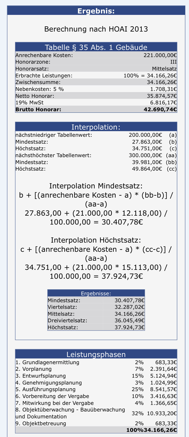

Ruhrgebiet2326 Jan 2019 20:31I haven’t seen a surcharge for remodeling.
But what exactly is this about now? If the fee is too low, should one expect inadequate support? I’m not quite sure where all this is leading.
Ruhrgebiet23 schrieb:
I didn’t see any renovation surcharge.
But what is this about now? If the fee is too low, should you expect that the service won’t be thorough? I’m not quite sure where this is leading.That’s exactly right. Nobody gives 100% if they only earn 50%.R
Ruhrgebiet2326 Jan 2019 20:34But we didn’t really negotiate or anything. We stated what we needed and then received the offer.
R
Ruhrgebiet2326 Jan 2019 20:38Alright, but that should have been communicated as well, shouldn't it? So, you can't just say now that everything can ultimately be accepted because he isn't being paid adequately?
